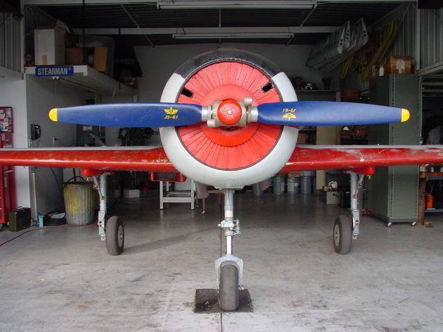

PostPosted: Tue Nov 04, 2014 2:47 pm    Post subject: Re: Metal Prop Reply with quote
Will an Avia V520 fit?
 Filesize:  40.81 KB
 Viewed:  19011 Time(s)
 Filesize:  40.81 KB
 Viewed:  19006 Time(s)

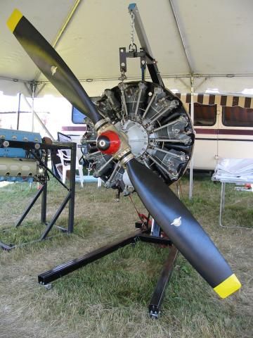

PostPosted: Tue Nov 04, 2014 3:06 pm    Post subject: Metal Prop Reply with quote
Call M14P. They installed Chinese blades in Russian hub. But it was for ground tested only, I think. It never flew; not sure why.
On Tuesday, November 4, 2014 2:39 PM, Cory Robin <crobin(at)skyvantage.com> wrote:
My M-14P is on a Wilga. I fly from backcountry/unimproved strips all the time.. Taking rocks through my all composite Whirlwind propeller is really proving to be bad news. So I'm open to options appropriate for my application.

[quote]Call M14P. They installed Chinese blades in Russian hub. But it was for ground tested only, I think. It never flew; not sure why.

There is a Chinese propeller named JL-2B can fit M-14P.

Although the Russian and Chinese prop hubs appear very similar, the threads on the blade shanks of the Chinese blades are very coarse compared to the threads on the Russian blades. Thus it would require replacement of the castellated nut assemblies. If I remember correctly, the large, flat bearings are the same size. So maybe the assemblies are the same size too. I wonder if it is possible to remove the castellated nut assembly on the sides of the Chinese hub and install them in a blank Russian hub? If that were possible, I guess one could use a set of Chinese metal blades. But I don't know if the castellated nut assemblies will interchange or not.

I had a set of JL-2 blades on my 400 hp Husai engine. They were making a similar set up for the M-14P. Ffrom my experience the Chinese metal three-blade set up was VERY smooth and powerful. Only penalty was the extra weight.

Also, I don't know the max design RPM limits on the Chinese blades which turn 2400/2450 when installed on the HS6A engine. Turning them up to the M14 capable RPM of 2900 could possibly stress the blades more than they were designed to be run at. If Jill at M14P did some testing on this, she may know the answer.

As is the Chinese Huosai engine. Max. engine RPM is 2350, with a gear ratio of 0.787 that is a Max. prop RPM of 1850.
Walt

The M 14 P is, of course, a geared engine, so the propeller turns at 0.658 times the speed of the engine. So at 101%, which equates to 2950 rpm, the propeller is turning at 1941 rpm!
Dennis
A. Dennis Savarese334-546-8182 (mobile)www.yak-52.comSkype - Yakguy1
Dennis

I doubt that the Chinese two blader would handle the extra power of the M14. I suspect it would have trouble governing the max RPM.

Two blade Chinese prop named J9-G1, you can not install it on M-14P. JB-2A is 3-blade metal prop for 4000hp HS-6K, only JL-2B can fit M-14P.
