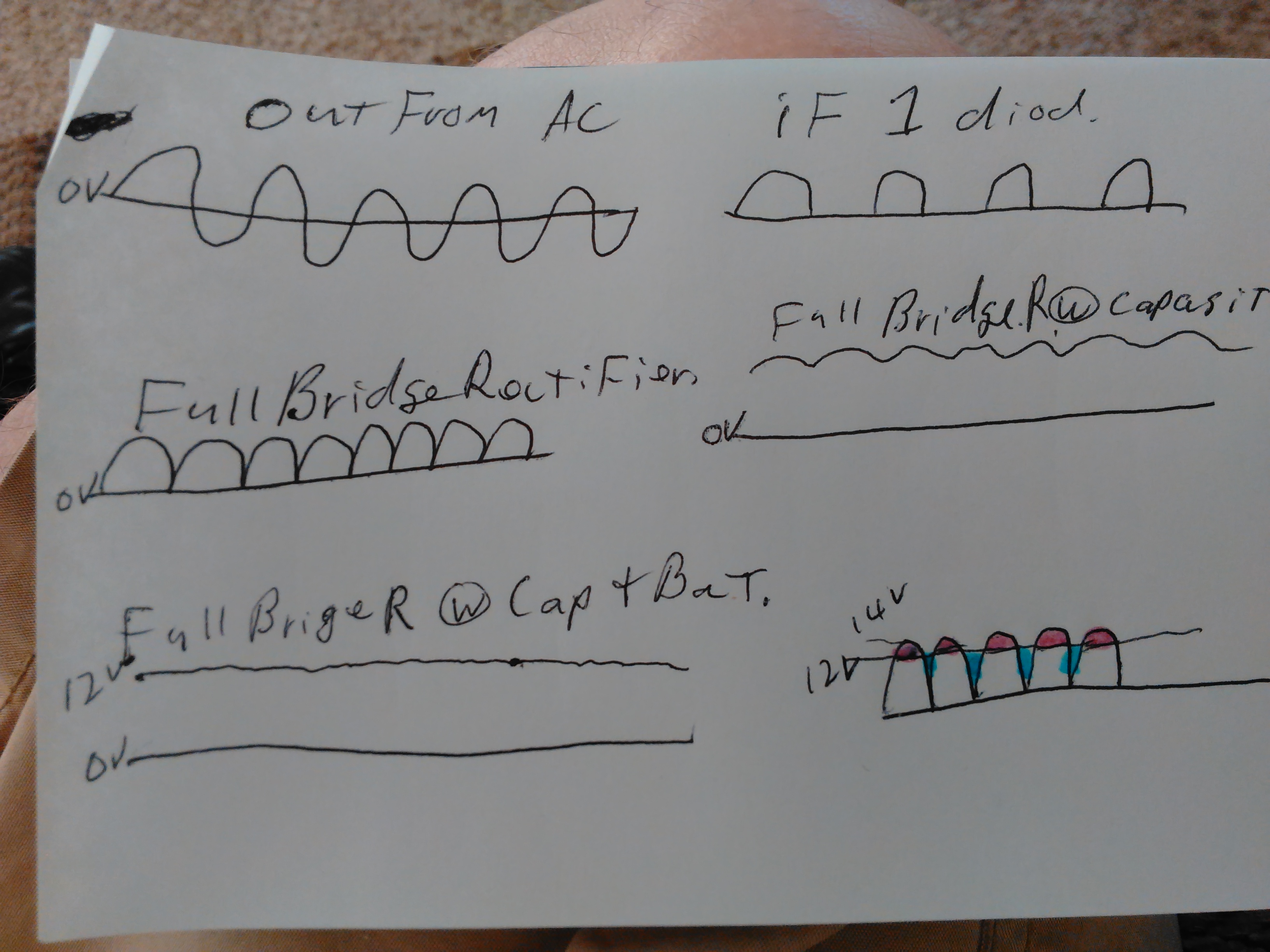

Our aircraft while running will put out anywhere from  10 to 35 volts ac.    Some equipment will run on ac.   Most needs DC.   In order to convert ac to DC we need some type of rectifier.   The most simple is a single diode.  Which will provide pulsating DC.   If we use 4 diodes we get a full bridge rectifier.   It still provides pulsating DC but with twice the energy.  By adding a capasitor the pulsating DC becomes a rippled DC.   Adding a battery smooths it out even more.  Depending on the frequency the addition of an inductor may also help.    Tmi  too much information
A 12 v ac circuit will push 1 amp through a 12 ohm resistor.     BUT  if you look at it with a peak to peak ac meter, or an oscilloscope it will show  14 1/2 volts plus or minus  but on an rms (root mean squared) meter it will show 12v.    To get the average 12 volts out of 14 1/2 volts,  the top of the voltage curve is clipped off and used to fill in the gaps  see the red and blue in last illustration.
