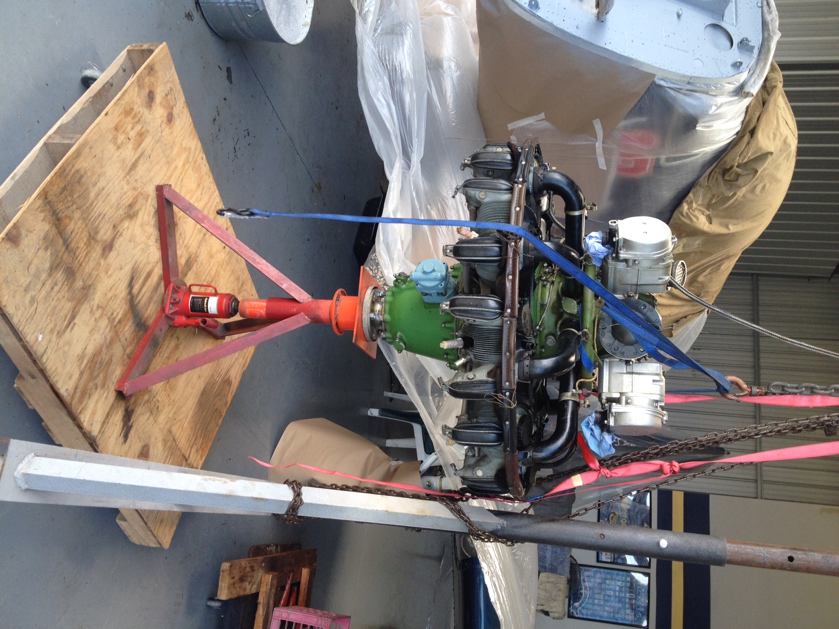

In the process of Housai to M14P conversion and just removed YAK ring for the CJ ring and you do need to remove both Mags and the oil pump but it will fit over the compressor and carb. If you have the Russian mag wrench (long extension 13 mm I think), it is useful for the mag nut next to the ring (very tight). Flipping the motor so it is nose down makes working on the aft portion/accessories and mount much easier and below is a pic of what I used (thanks Pappy). Fab a plate with the prop flange hole pattern and a jack stand on a sturdy pallet on wheels and u can spin motor around and move easily. Refer to George Coy's tutorial on mag timing...let me know if you need it.
More ways to skin this cat but it all worked for me; of course the key part of all this is your hoist system...Hope this helps.- Hoot

Hoot is correct. Just need to pull the mags. Do not recall having to pull my oil pump to remove my ring. Has been a couple of years since I rebuilt my M14 though.
On second thought, no I did not pull the oil pump.
