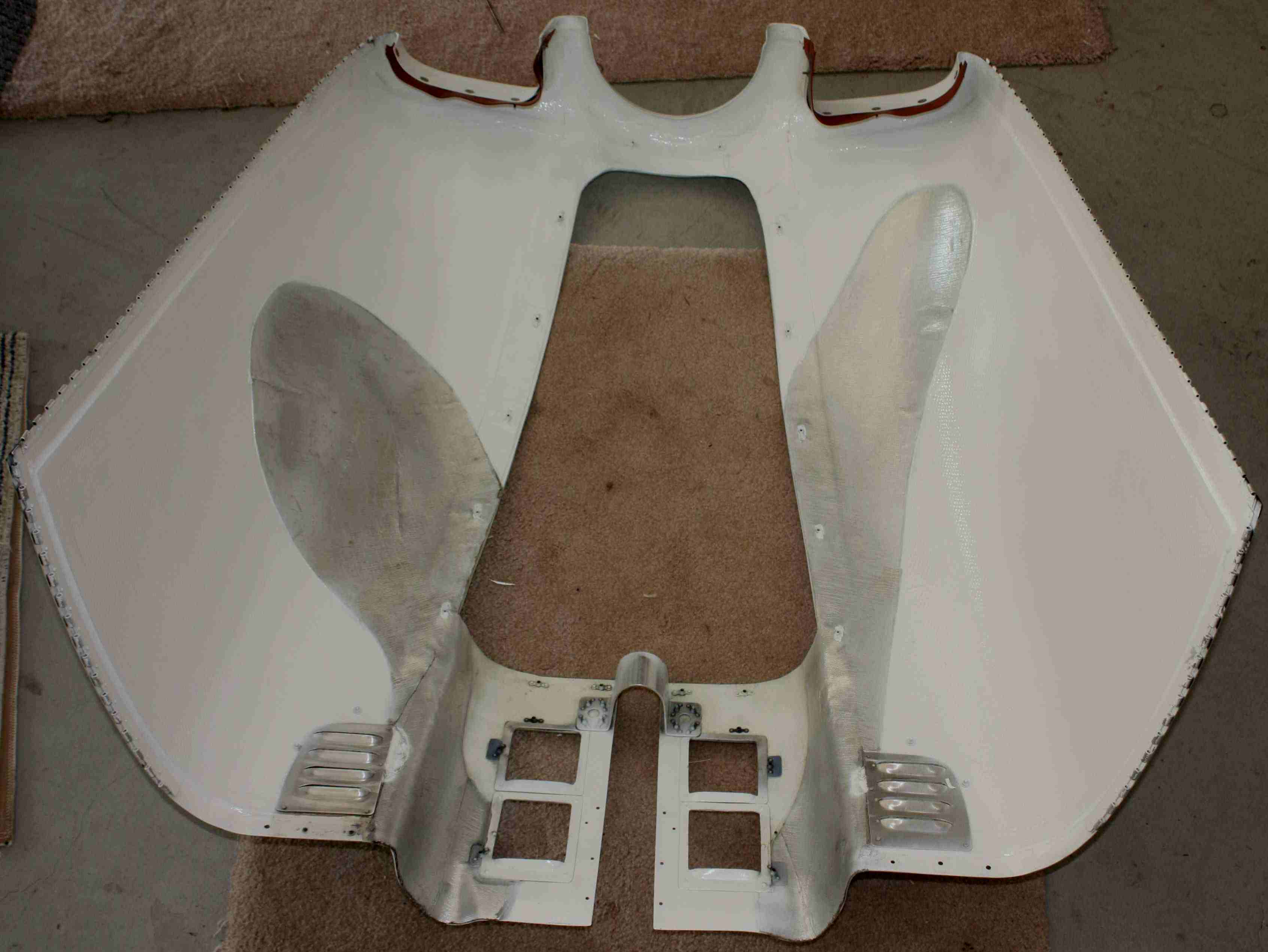

PostPosted: Thu Oct 16, 2014 8:25 am    Post subject: Exhaust clearances Reply with quote
Just remember, just as a cars engine compartment is never as hot when running down the road as it is when you stop, and shut the engine off.... the plane is the same way. Just reach inside with a pencil and mark where the bottom cowl gets close to the any of the exhaust headers, then install some 2,000 degree race reflective tape.... the "better to be safe than sorry" expression applies here.
Even though I have cold air induction and higher compression, so parts of the bottom cowl are different, you should still end up with temp tape looking something like the attached pic.
Don McDonald
