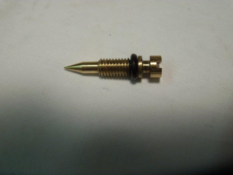

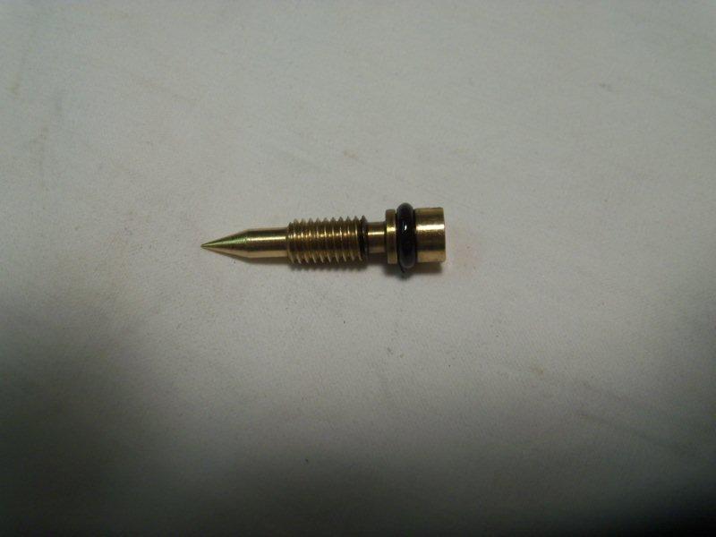

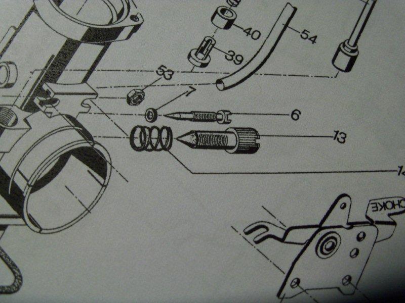

OK guys, since my idle mixture screw does not look like the ones in the book
(#6 in the drawing), I have a question.
Which is the proper position for the O-ring?
Next to the threads, or in the groove closest to the head?
When I took the carb (Bing 54) apart for an overhaul last winter, I forgot
to take pictures as I went. No problem, I have a parts drawing, and there
were no two parts alike, so things can only go in one place. When I went to
put it back together, I had a little debate with myself about the placement
of this O-ring and the parts drawing was no help. I used my "best logic" as
to where to put it. I think I was wrong and will continue the story after I
hear some replies. Smile

PostPosted: Thu Oct 09, 2014 3:35 pm    Post subject: idle mixture air adjust screw, O-ring Reply with quote
I would put it in the groove closest to the screw driver slot ( head)

PostPosted: Fri Oct 10, 2014 5:31 am    Post subject: idle mixture air adjust screw, O-ring Reply with quote
That is what I thought too.  Why else would there be an O-ring sized groove in the screw?
As it turns out, I could not get it to idle properly, even with the screw turned all the way in, it was still too lean.
After moving the O-ring to be next to the threads and setting the screw to ½ turn, I was able to dial in the idle mixture by turning the screw only a tiny amount.
It would have been a lot easier if the screw were not on the propeller side of the carb, but what the heck it worked!
Stuart
