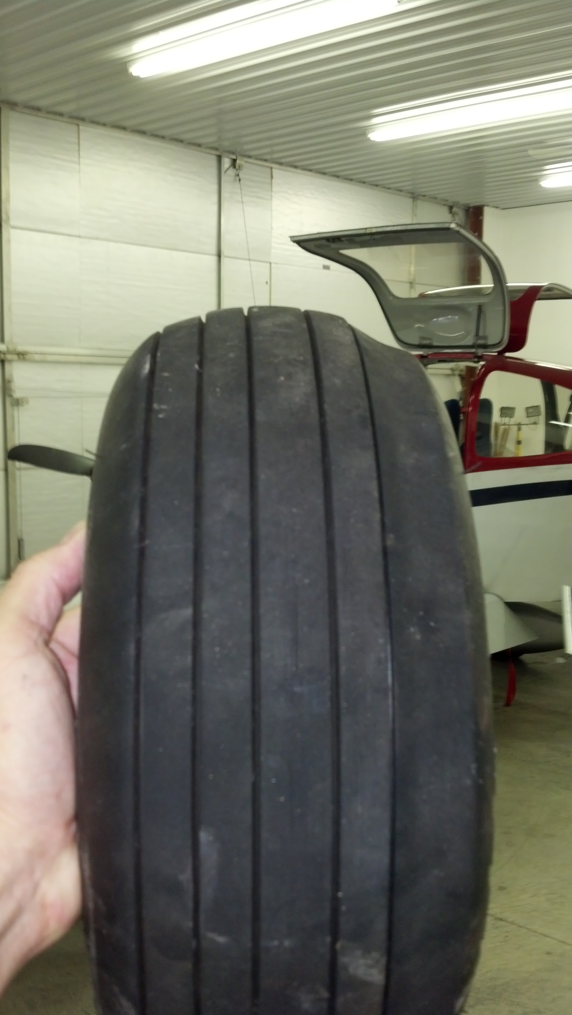

I had a rolled caliper piston O ring on the left side at ~100 hours. I also found this on a pre-flight – noting unusual wear on the left tire (photo attached). Pulling the wheel pant I found the brake pad to be essential gone. Pulling the caliper off the piston popped out on its own. My guess on what happened was the rolled O ring caused the piston to remained extended enough with no brakes applied to drag the tire on take offs and landings to cause the wear. I estimate this all happened in ~20 hours of service.
Replaced O rings, pads and tires on both sides. Last 100 hours have been trouble free.
Carl
