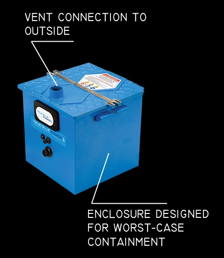

Getting a lithium battery to burn is like any
other catastrophic energy release in that it
takes a combination of stacked conditions. In
the case of an ENGINE CRANKING / STANDBY POWER
battery, the first condition we'll strive to
minimize is the choice of chemistries.
My preliminary findings working with the 26650
liFe cells purchased off eBay suggest that their
ratings, and coincidentally their in-service
risks for abuse, are strongly influenced by the
boundaries on charge/recharge limits. Many articles
I've read suggest that optimum battery life is
achieved if the cells are cycled between about
80 and 20 percent of their chemical energy limits.
The hybrid vehicles program their battery management
systems to keep routine cycling of the cell packs
within these or similar limits thus accepting
a designed-in de-rating of battery capacity.
This de-rating along with choice of a chemistry
with the most robust resistance to conflagration
suggest that fire-brick battery boxes are probably
overkill. Lowered risks for LiFe fire not-withstanding,
the lithium products finding their way onto TC
aircraft ARE being housed in enclosures that
ASSUME a potential for the worst . . . said
enclosures are designed to contain a battery
fire and vent products of combustion overboard.
Know too that these offerings have a significant
proportion of procurement expense tied up in the
battery management system electronics!
[img]cid:.0[/img]
http://tinyurl.com/l6xbev7
As of this date, I'me aware of no similar
prophylactics against catastrophic failure being
offered to the OBAM aviation community.
[img]cid:.0[/img]
