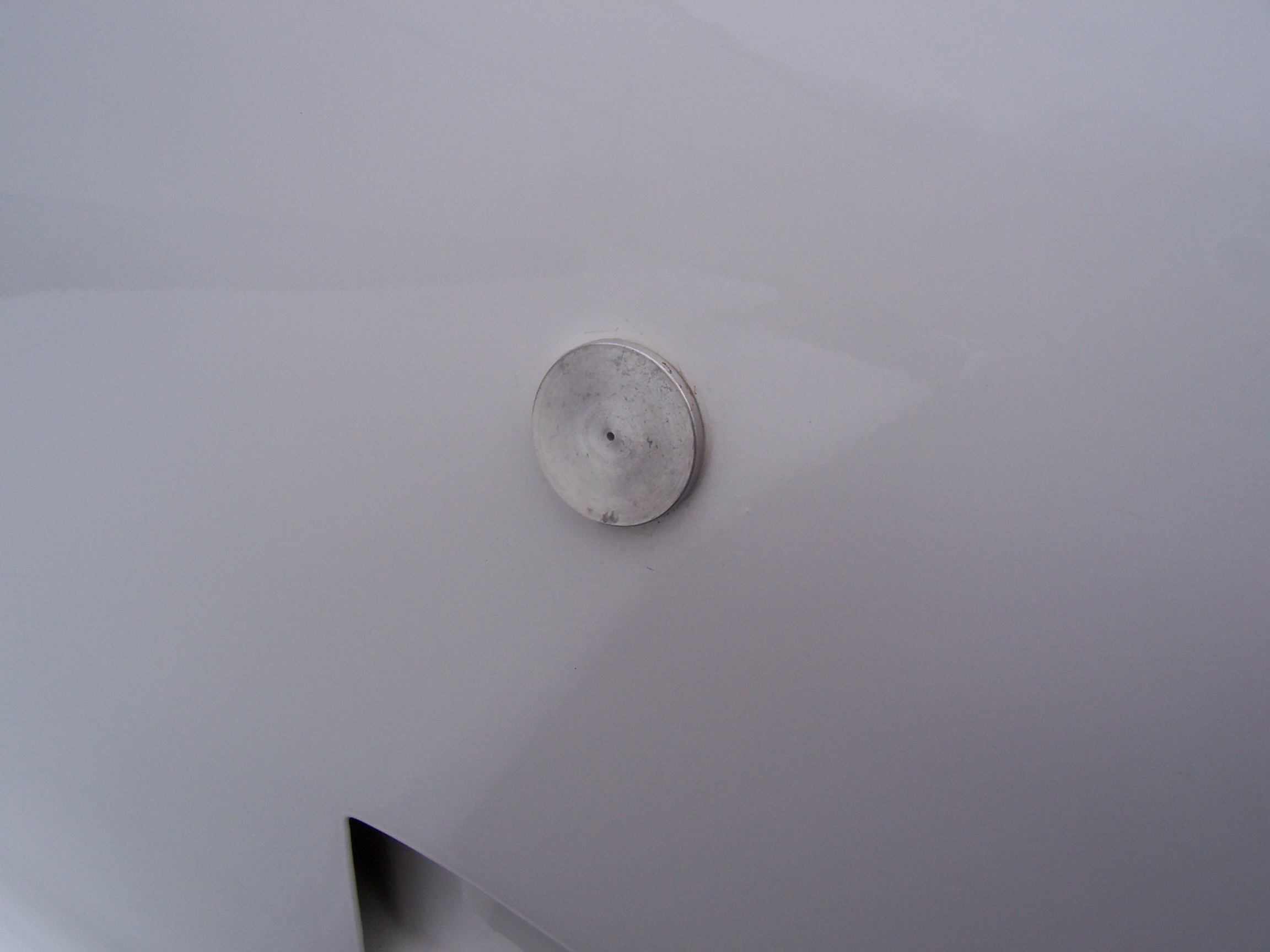

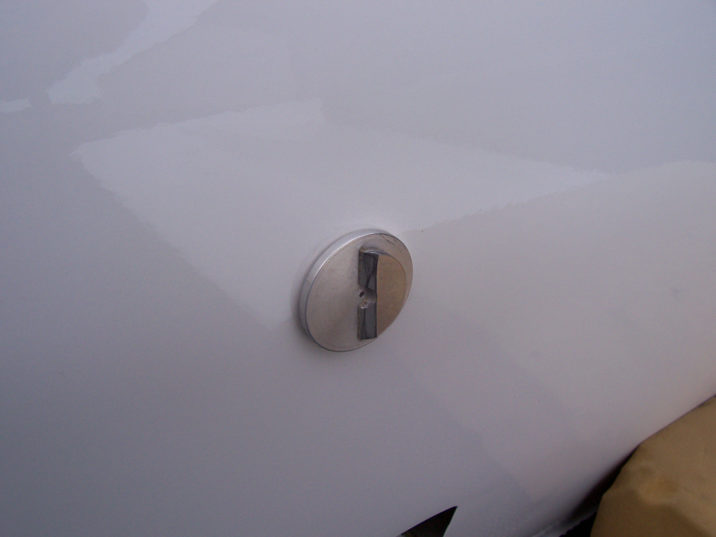

Hello KIS Listers, As mentioned earlier attached are copies of pictures of the two static ports on the forward fuselage sides of my KIS TR-1.
One port has a home made wedge to create an increased static pressure at the static port, 100_602. The other one, 100_599 does not.
The wedge has the effect of the airspeed indicator seeing a slightly increased static air stream pressure which results in a slower airspeed indication on the airspeed indicator needle as balanced against the dynamic air stream pressure coming from the pitot tube into the airspeed indicator.
This slight change in static airstream pressure causes me to speed up a bit to see a specific airspeed indication number on the instrument.
This wedge – no wedge combination on the two static ports gives me the airspeed and altitude information that I want to see in the cockpit.
