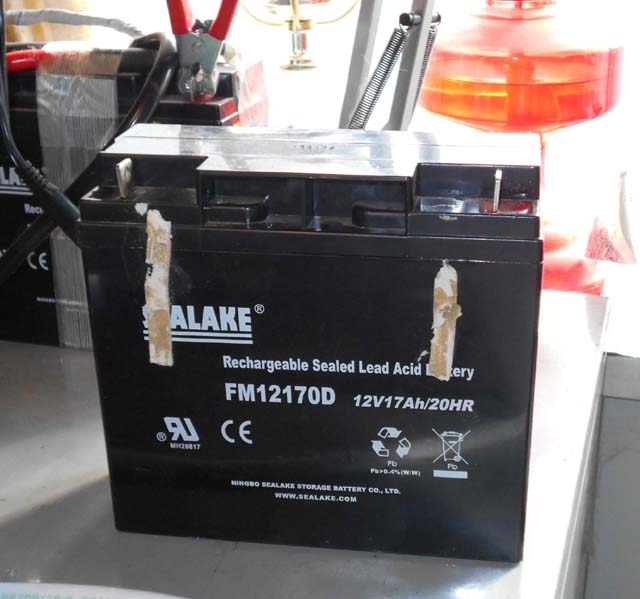

Excellent point. The rules that set energy limits in
chemistry are pretty much carved in stone. A couple of years
ago we were offered some batteries marked as if they were
in a larger class of product than reality revealed.
[img]cid:.0[/img]
I've still got a couple of these I keep for various
tasks but they're closer to a 14 ah battery than 20.
One of the first things we noted about these critters
was their light weight.
The rating of lithium cells comes with another constellation
of facts in physics. I'm doing some articles in Kitplanes
on lithium . . . I've been testing some 26650 cells
off eBay where you'll find them 'rated' from 2400 to
6600 mAH. How can THIS be? Seems that this chemistry's
life-cycle is extended greatly by NOT stuffing the
chemistry to full capacity on each recharge cycle.
The more conservative offerors of these cells
seem to encourage longer life by rating them
at much less than the chemistry's max capacity.
So once again, weight of the cell is a strong
first marker in potential performance with
recommended performance being something more
reserved.
The next article will discuss my discoveries.
