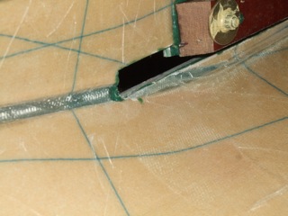

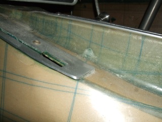

Do these help?
Photos from my installation.
Alan
G-OBJT

rowlandcarson(at)gmail.co
PostPosted: Sat Sep 20, 2014 6:53 am    Post subject: retract lever slot Reply with quote
On 20 Sep 2014, at 12:21, Alan Burrill <alanb(at)dpy01.co.uk> wrote:
Do these help?
<DSCF0663.jpeg>
<DSCF0657.jpeg>
Alan - thanks for your message & pictures. The second one does seem to show a similar situation to mine. Initially I had difficulty working out the viewpoint of the first one; the lines in the pre-preg can confuse the perspective and make it look like an external corner. I see now it’s taken from the underside looking forward and into the internal corner, and certainly does show that the slot comes pretty near the edge of the tunnel.
Thanks for the confirmation that my measurements are OK.

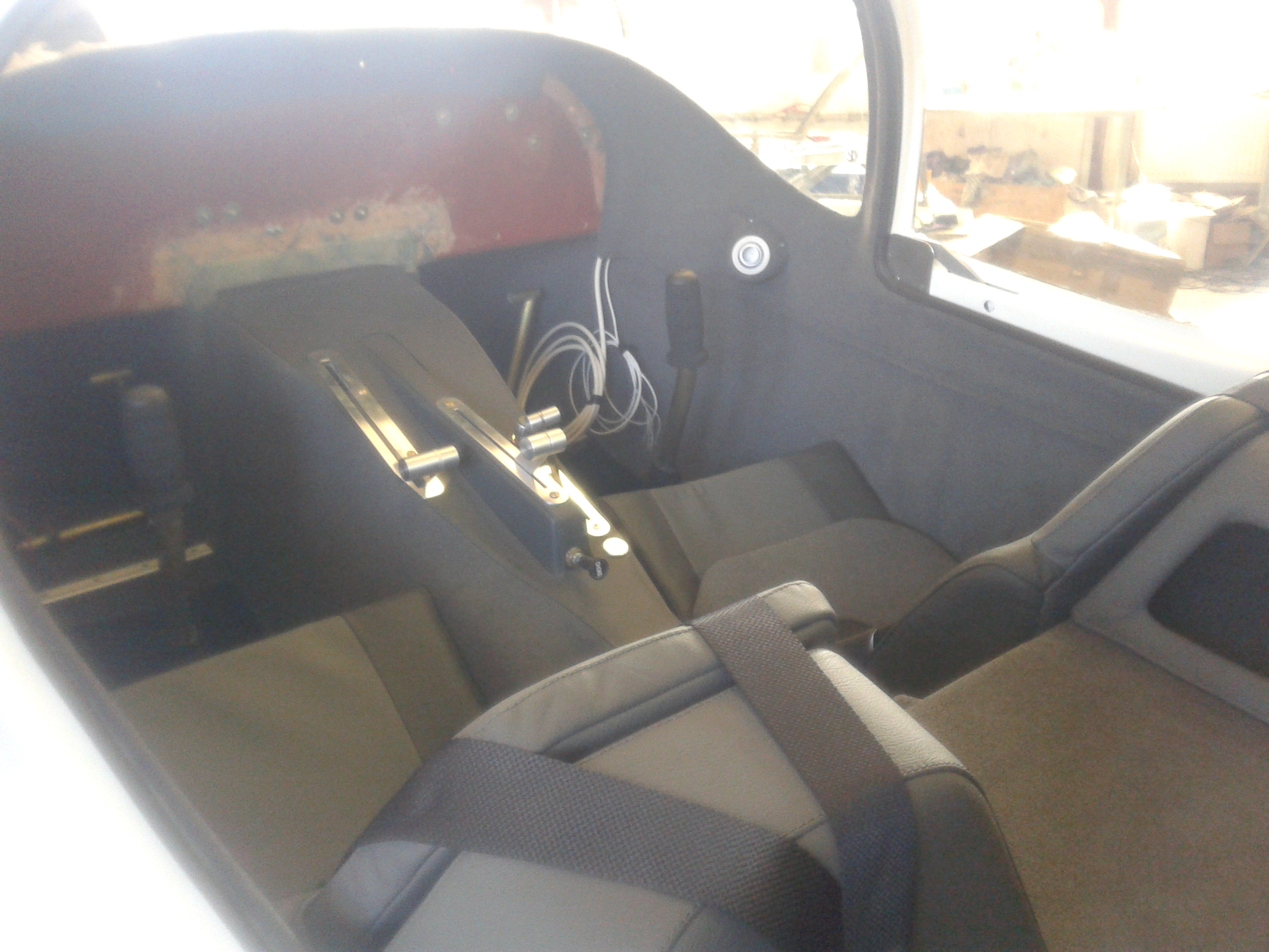

PostPosted: Sat Sep 20, 2014 7:51 am    Post subject: Re: retract lever slot Reply with quote
Hi Rowland,
This is how mine looked after fitting and fettling - sorry I haven't got any carpet, but the general idea is the same...
HTH,
Paul M
