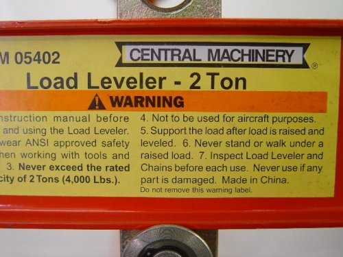

PostPosted: Sat Sep 13, 2014 1:06 pm    Post subject: Engine removal for SB 14-08-29 Reply with quote
One very helpful item is to have a load leveling bar on the hoist, which lets you tilt the engine quite a bit forward or aft as needed. IIRC they are not terribly expensive at Harbor freight, or you may be able to borrow one.

PostPosted: Sat Sep 13, 2014 1:47 pm    Post subject: Engine removal for SB 14-08-29 Reply with quote
Yep, I have one. The one with those immortal words, "Not to be used for aircraft purposes".
