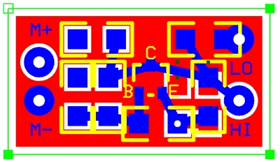

I'm about ready to order an etched circuit board
[img]cid:7.1.0.9.0.20140831140604.01f94748(at)aeroelectric.com.0[/img]

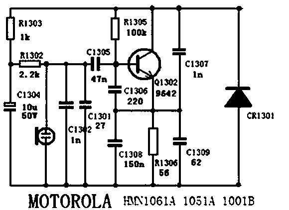

with a schematic patterned after D.L. Josephson's suggestion
earlier this year.
[img]cid:7.1.0.9.0.20140831140604.01f94748(at)aeroelectric.com.1[/img]
Should have boards by end of next week. The finished amplifier
will be 0.48" wide by 0.83" long

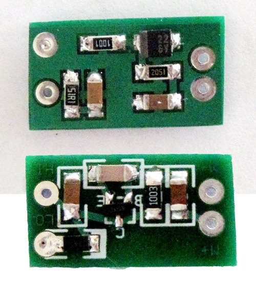

Got the first-article assembled . . . but I need to
put the fun-stuff down for a bit and do something to
keep the boss happy.
[img]cid:7.1.0.9.0.20140910160635.01f93a10(at)aeroelectric.com.2[/img]
Might get to power it up later tonight but tomorrow for sure.
