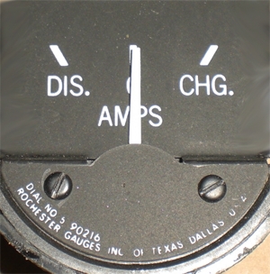

Here's what I like about Battery Ammeters:
1. Using a zero-center ammeter provides info on the health of the battery charging system when everything is
working properly. By learning to watch the charge taper after start-up you can glean info about the health of your battery & charging system. Learning to watch trends: "hey, that looked different than it did last time I started-up. What's up with that?"
Yes, it has that functionality . . . my first car ('41 Pontiac) had one and it took a bit to figure out the nuances of behavior. But is THIS a useful way to track battery condition. If you're a day-vfr airplane and you don't care about battery capacity, then you run the battery until it doesn't crank the engine any more. You're more likely to replace the battery because it is given you soggy starts than if 'the needle is returning to zero just a tad too soon'.
If you have specific endurance goals then unless those goals allow you to run a battery down to 80% of new capacity, then you're not likely to see much of an accelerated recharge rate on the battery ammeter when in fact, it IS time to replace the battery.
2. When the alternator fails, the ammeter automatically becomes a load meter to aid the pilot in load-shedding, if necessary. Exactly the info you want, exactly when you need it (without flipping any switches).
Say what? Your Plan-B is "flip switches until you see what you like"? This presumes, of course, that what-you-like is consistent with prior knowledge of battery capacity and you KNOW that the what-you-like-reading is going to get you on the ground.
Plan-B is best crafted by (1) maintaining a battery at some level consistent with design goals and (2) knowing exactly what loads are to be shed after alternator failure - BEFORE TAKEOFF.
What I don't like about Alternator Load Ammeters:
1. Alternator load is not a very useful piece of information
Do you really care what the alternator is putting out?
Nope, that's what I've said. Ammeters are of little use as an in-flight, system management tool. Of course, you get the same behavior from the alternator load meter after engine start as you do with the -0+ battery ammeter . . . a peaking of demand while the battery is being recharged that tapers as the battery recovers. Same date.
Will you take any action if the alternator load is 25 amps or if it is 40 amps - as long as the alternator is working properly, it's replacing the necessary volume of electrons to handle the load... automatically. It is either working properly or it isn't.
Actually, I've had an instance for loosing one phase in an alternator on a car that I had bought. The a/c was out so I didn't run blower loads until months later during heating season. Only then did I discover that the battery would not get recharged during night ops with both head-lights and blower.
When diagnosing the system I discovered that the alternator was de-graded to about a 15-20A machine . . . adequate to all ops when the blower was off.
The factory stock alt warning light never did come on. In any case, you're correct that if a low-volts warning light is dark, then alternator output, what ever its limits are, is adequate for the current task.
2. Alternator Load is kind of a muddled number. It is neither buss load nor is it battery charge current. Those are 2 numbers I care something about but Alternator Load gives me neither.
Which is precisely why it's not a flight ops display . . .
I'm unaware of a scenario where I would see some value on the Alternator Ammeter and say "I better do something about that!" If it is too high, indicating a full-field condition then I presume the my over-voltage protection system will kick-in (probably before I even have time to look at the ammeter) and shut-down the regulator. If the alternator stops making power, my low-volts alarm will go off and my Alternator Load Ammeter is useless.
Absolutely . . . and so is the battery ammeter.
Lord Kelvin once opined:
“When you can measure what you are speaking about, and express it in numbers, you know something about it, when you cannot express it in numbers, your knowledge is of a meager and unsatisfactory kind; it may be the beginning of knowledge, but you have scarcely, in your thoughts advanced to the stage of science.”
A load analysis is comprised of measurable values. Capacity checks produce measurable values. Endurance based on known capacity divided by verifiable load is a number base on measured values.
Look through the POH for any TC aircraft having a battery ammeter and see if the manufacturer offers a narrative on its use as a in-flight tool beyond an obvious failure of engine driven power source.
[img]cid:.0[/img]
Most are no more carefully calibrated than the stock ammeters on cars of the era . . . doing the battery ammeter was easy, doing a low volts warning light not so much. But it DID satisfy the FARs for offering the pilot a means of monitoring health of the GENERATOR . . . not the battery.
Nowadays, the low volts warning is child's play.
