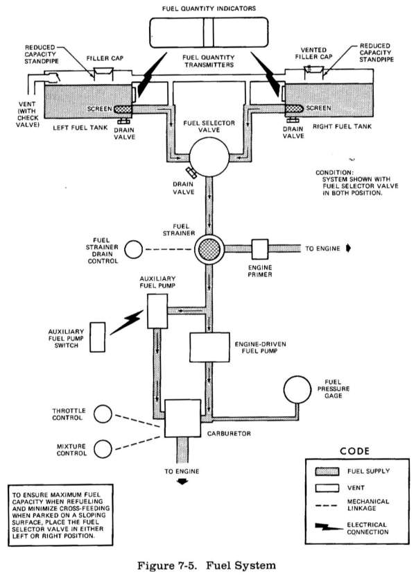

But how much is there to diagnose engine
stoppage in a 172. One flies on BOTH tanks,
BOTH mags and it's a gravity feed fuel
system to the strainer sump. If the engine
starts to fade, the elapsed time from when
your hand starts to move toward the boost pump
switch (while glancing at fuel pressure gage)
is but a second or two . . .
[img]cid:.0[/img]
That airplane is a fine example of risk reduction through
simplicity. Short of catastrophic failures from which
there is no engine recovery, likelihood of failure due
to anything but dry tanks is vanishingly small.
Critical systems management needs to be as automatic
as the practiced flare looking for a greaser. This
system offers not the slightest risk of needing
to fiddle with the manual . . . or sift through
post-it notes on the panel.
