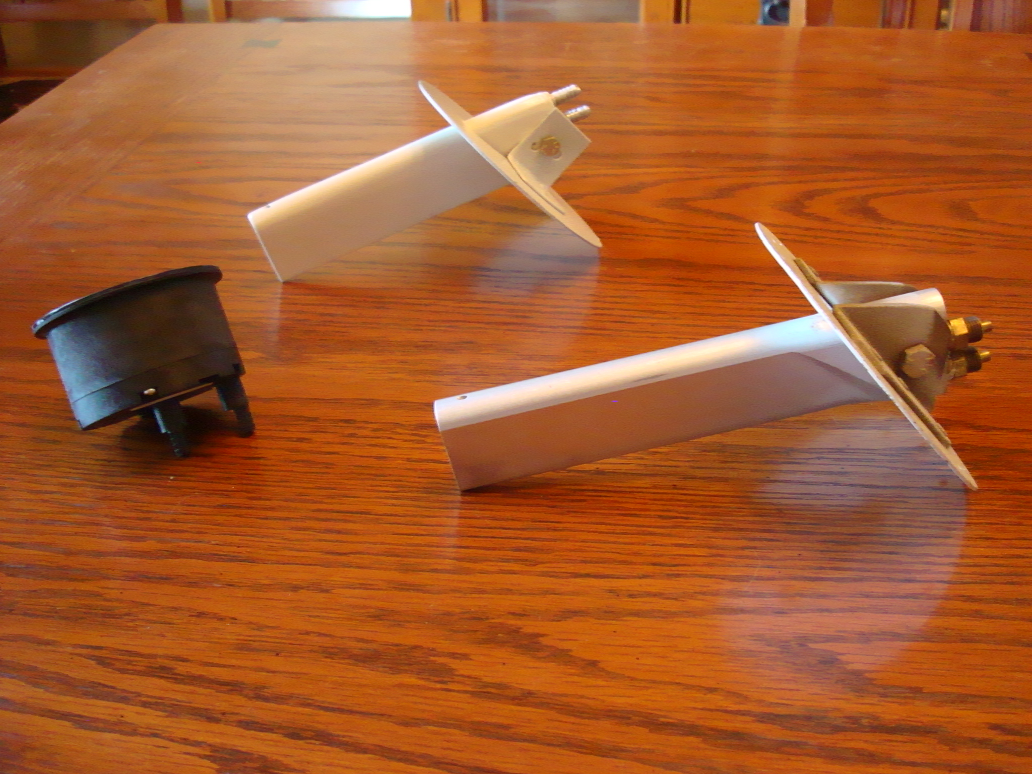

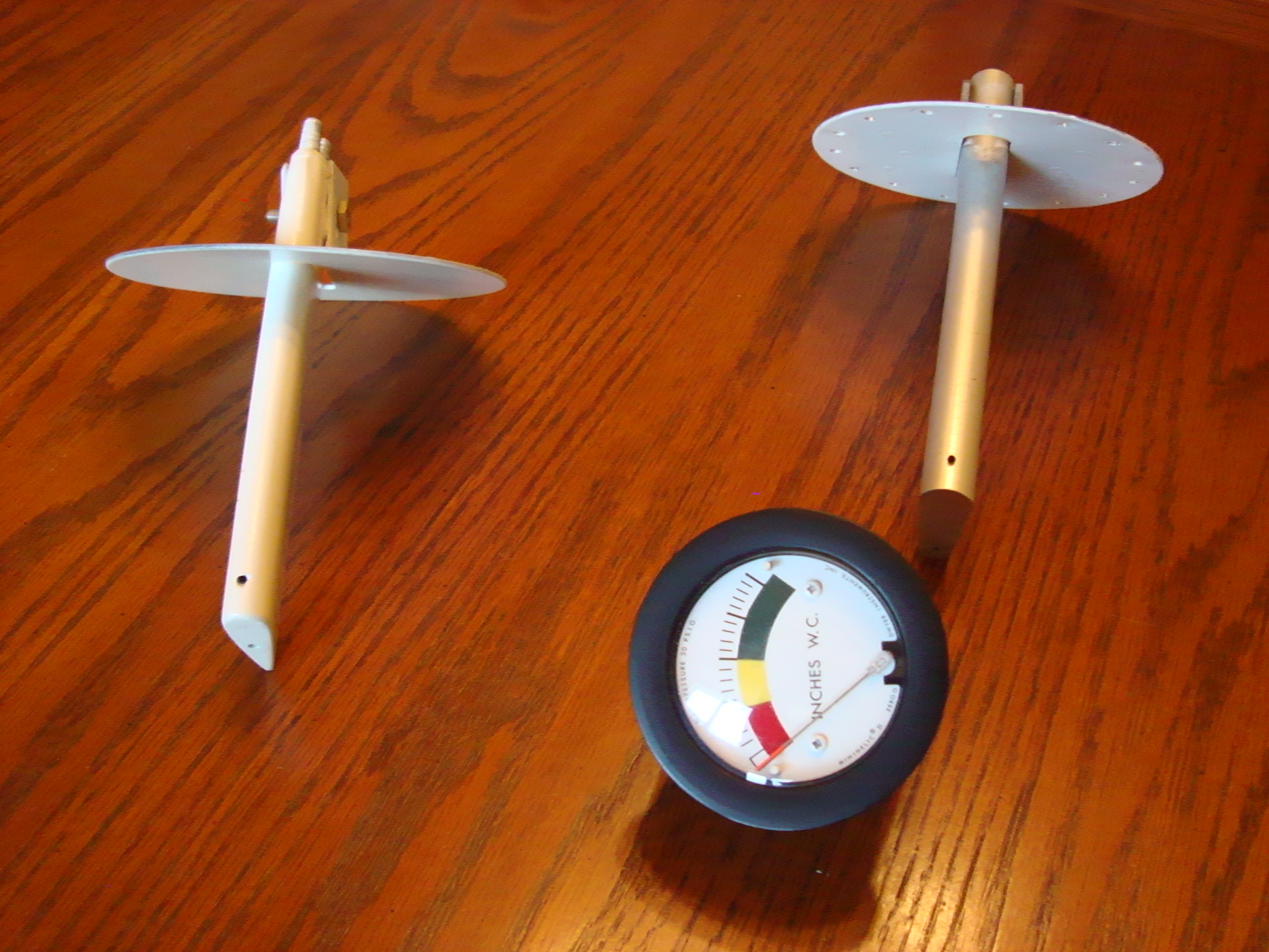

Russ,
      The following pictures features LRI, Corp's lift reserve indicator pitot mast, along side my version.  Their's is the aluminum one and is longer than the one I made.   It is also a fair amount heavier.  I made mine out of 1/2" thick Lexan that I had a large piece of.  The reason mine is shorter is because I only had a 6" drill bit.   I suppose I could have come up with an 8" long  (1/8") drill bit, but I didn't think being 2" shorter needed to be so critical if the pitot mast is positioned properly (far forward).
  The gage is a Dwyer Minihelic 2-5002, 0-2" W.C.     But like I said, Dwyer has that exact same pressure version in metric, they just
label it with Pascals or whatever.   eBay usually has a fairly decent selection of the range we'd want.
  If someone wants to make their own AOA/lift reserve indicator, I'd suggest studying this article;
 http://www.ch601.org/resources/aoa/aoa.htm
  I would also recommend that if you really want to build one, and you have questions on how to fabricate any of the parts, give me a call.  It would be far easier to explain over the phone how to do something than for me spend 4 hours trying to explain something that doesn't need explaining.
  In a nutshell, here is some facts on the LRI set-up;
a)   the pitot mast has two ports, the front and the bottom.  Their position is shown in the drawing in the above link.
b)   Aircraft Spruce sells the yellow/red/green stick-on arches.  I recommend that, unless you have some sophisticated
way of making vivid color arches.
c)   the pitot sticks out through the circular round mounting plate.  You need to allow enough clearance around the mast itself for
adjustment for proper calibration.
d) a hairdryer and a Hall wind meter works pretty well for getting the angle figured out "approximately".  You have to make a jig to hold the hair dryer, and a jig to hold the pitot mast.  Or you could use a car and a digital level if someone else can drive the car for you.
d)   it is a fun project, and shouldn't cost but a few bucks.  I think if I were to build another mast, I'd think about trying to make a
fiberglass one.  Not that the Lexan one is weak, but for ease of shaping it and all, I'd try the fiberglass next time.
e)   the factory uses threaded tube fittings.  I thought that wasn't necessary in my version, so I epoxied alum. tubes.  VERY strong!!!
f)   there's a bit of a trick to drilling 8" in 1/2" material and not poking out on the side.  Ask if you're interested.
   If anyone wants more information, call me.  Easier to talk than type.
