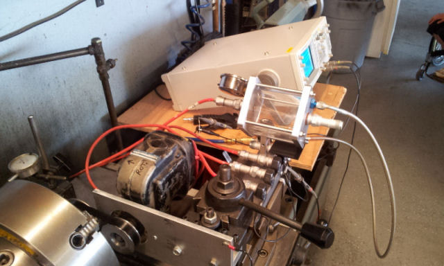

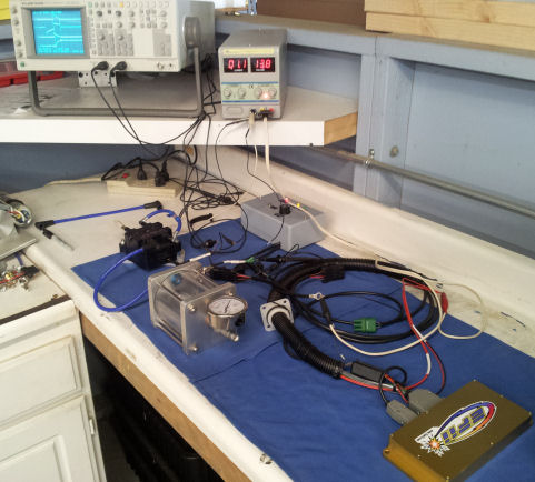

At the EFII facility at Cable Airport in Upland, California we gathered up the most popular choices for ignition systems on Lycoming engines to do some comparison testing. The results were very interesting and brought up some important differences between the systems tested.
The systems tested were:
Lightspeed Plasma II+
P-mag 114
Slick Magneto
EFII
There are other ignitions available for Lycoming engines. Those listed above appear to be the most popular choices in today's market for experimental aircraft.

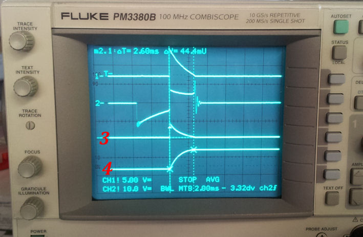

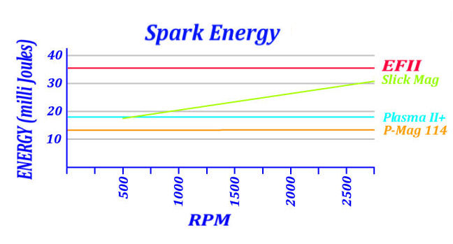

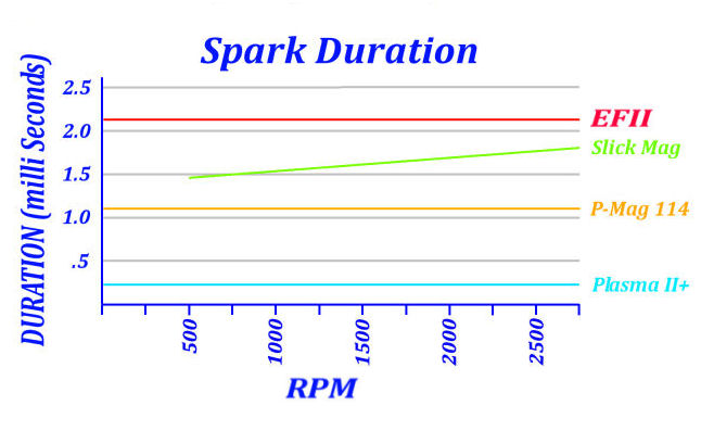

We measured the spark energy, spark duration, and system current draw of each of these systems. Below are graphs of the data that resulted. The ignitions were run under load. This means that the instrumented spark plug was mounted in a pressurized chamber of inert gas to simulate the electrical load that the spark gap sees when it is inside the combustion chamber of a running engine at high rpm and high horsepower.
System current draw at 2750 rpm: P-Mag » none; Slick Mag » none; Plasma II+ » 1.5 amps; EFII » 1.2 amps

There are some interesting items in the data:
Notice the increasing energy of the magneto as rpm increases. One drawback of the magneto ignition is very low spark energy at cranking rpms. Impulse couplings are commonly used on starting mags to momentarily speed them up in an effort to get a little more energy during cranking. This helps, but the energy is still very low during cranking.
You might expect the P-Mag to have increasing energy with rpm also, but they have chosen to limit the charge time of the coil such that the energy does not increase as rpm goes up.
Another interesting item is the very short spark duration of the Plasma II+ ignition. This is a characteristic inherent to CD type ignitions. If the air fuel ratio is optimal, this may not be much of an issue. However, if you are looking for maximum power, you will be seeking an air fuel ratio on the rich side. Short spark duration ignitions will tend to misfire before long spark duration ignitions as you continue to add fuel. If you are a lean-of-peak guy, you have a similar situation where a short spark duration ignition will start to misfire before a long duration ignition as you take away fuel. These characteristics tend to favor long spark duration ignitions for best economy as well as for best power. This is a primary reason cars all have inductive ignitions. The long spark duration of the EFII ignition means that the spark is lit for more than 36 degrees of engine rotation at 2750 rpm. This gives lots of opportunity for a non optimal mixture to light.

Lightspeed claims > 130 mJ, which should be way off those charts. This would seemingly match the perceived benefits of CDI as well (high energy due to 0.5*C*V^2.  What's the whole truth here?  Is the 100 ohm series resistor messing things up somehow?  I'd like to see the measurement made using a current transducer instead of a resistance.

LSE claims their spark energy is "> 120 mJ" for all their ignition systems.
http://www.lightspeedengineering.com/Products/IgnitionSpecs.htm
