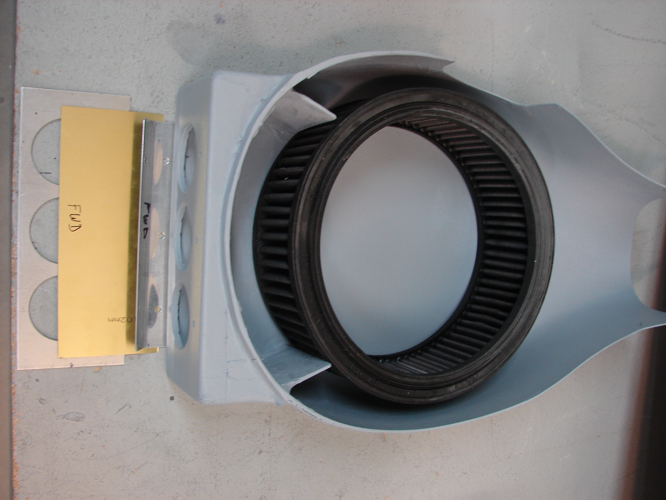

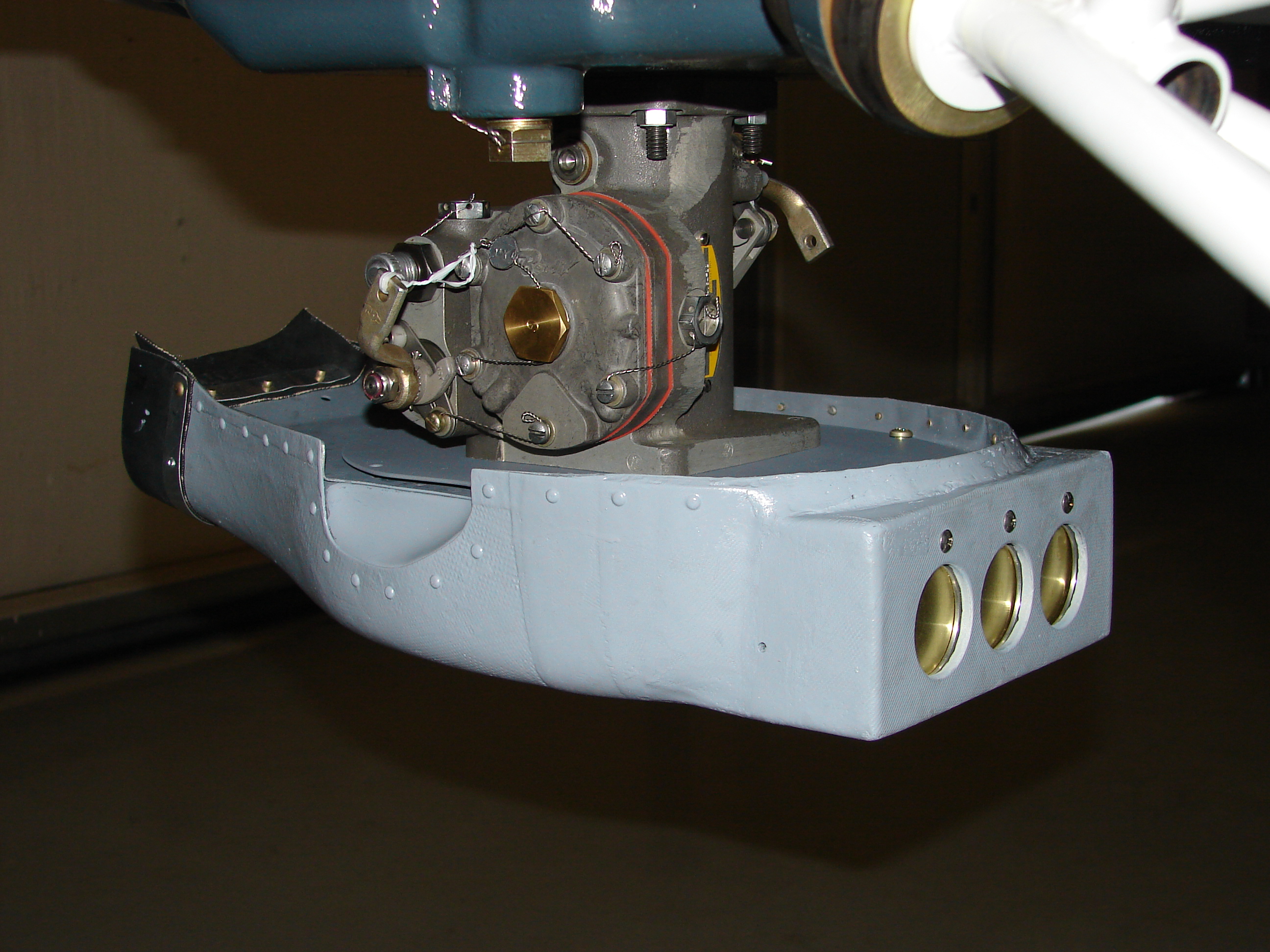

I have yet another mod that I did, this time to the fab airbox. With all the
feedback of the problems that some have had with the various Vans versions
of alternate air devises, I wasn't thrilled with any of them. My design
criteria is that there should be zero chance of ingesting anything into the
motor. That includes hardware that came loose from the fab, or anything else
the engine could suck in while in "alternate air" mode. That would even
include dirty, dusty or sandy air. The second feature would be that the
bypass must occur automatically. If I suck in a bird at 200 feet agl, right
after takeoff, I don't want to have to remember that bypass knob in the few
seconds before crashing. The solution was to use reed valves, as others have
done, but locate them not below the fab, but behind it. The aft section of
the filter is isolated with small dams, and when the reed valves suck in,
the air goes thru that section of the filter that isn't contaminated. In
that mode you still are breathing clean air, although at a slight decrease
in power due to loss of ram air. How much power? Tests on my flying RV8
showed about a 10% reduction during full power static runs. I will run a
similar test when I get the 10 flying. I have attached pictures, but they
may not come thru. If interested email me off-forum and I'll send them.
Chris Hukill

I'm all in favor of a better mousetrap, but a few things would bother me here.
1. I'd worry about the 'good' part of the filter getting water soaked from the inside, then later freezing.
2. At WOT you'll need something like a 200 ft/sec airflow thru those three holes, not sure if that is possible.

It did occur to me that one could mount a plate in front of the air filter to fore the air to make a turn, so that any snow, sleet, ice, hail etc would impact on the plate rather than the filter. Some cars used to have an arrangement like that.
I think if you are getting enough water to wet the back side of the filter you are in weather a light single has no business being there. Any time air has to change direction any liquid or solids will not make the turn. If the air is cold enough to refreeze water it means it is cold enough for ice on the airframe as well. I don't know what prompted Vans to even offer an alternate air, since they obviously believe in Day VFR as the conditions to fly an RV.
So far I have not  been convinced of the need for alternate air in the FAB as the plans show it. Maybe if you fly through a volcanic ash cloud you might severely plug the whole filter. And then you are faced with either loss of power or ruining the engine by opening the alt air.

That's some beautiful work.  Got a couple comments:
I don't have any numbers for how much filter area you need, but knowing Vans, I kind of doubt they provided any extra.  What I'm saying is, how do you know you have adequate filter area remaining after you dam off the alternate part?
Personally, I kind of think of the air filter as doing it's job over the life of the engine.  The odds of inhaling an adequately foreign object -- while running alternate air -- seem small enough to me to tolerate the risk.
How do you know it's working?  Indicator system?  Some other parameter that changes when the alternate is open?
While you're at it, look in the archives about mounting an aluminum plate under the filter.  It tends to wear through the bottom of the FAB.

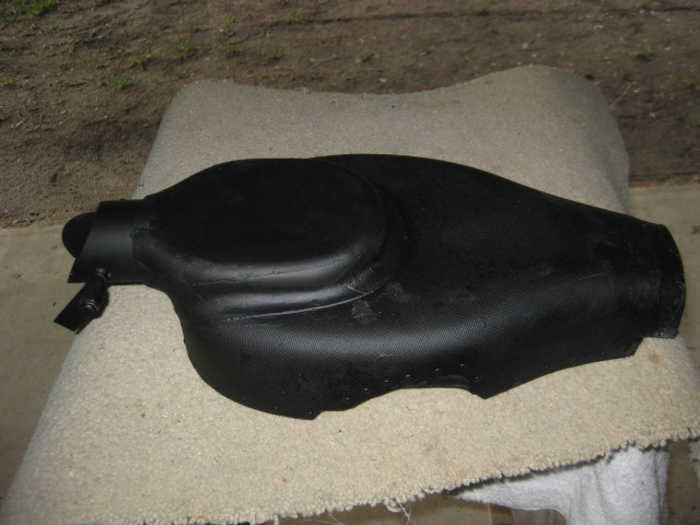

At least the alternate air wars have pushed all the other wars aside for the time being. I don't like any control that I can't reverse.  That's what drove me to this:
[img]cid:part1.00060902.09070407(at)cfl.rr.com[/img]
The air hole in the bottom of the FAB is the same size as Van's sliding one.  There is a piece of screen over the hole to keep out any FOD.  We've seen what large birds can do .... coming through the windshield ...... and one that nails the inlet in the cowl could strangle your engine if you don't have alt air.  I have to agree with Kelly though .... freezing rain or snow that will plug the filter will only occur if you're flying where you shouldn't be.
