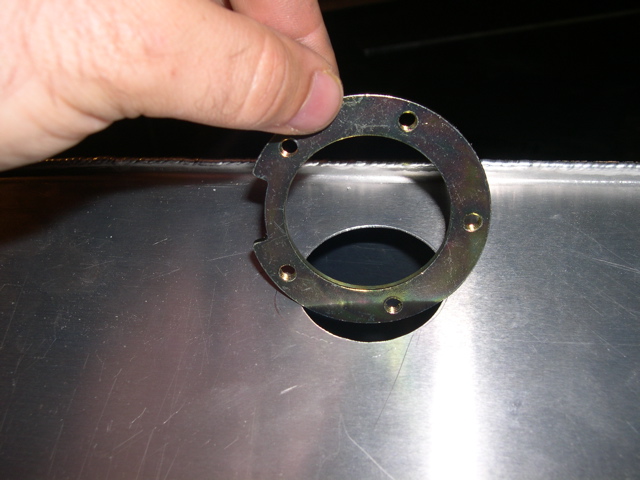

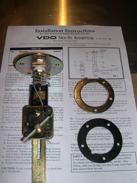

So I have my hole for the sender (older style sender - top mount).
And, thanks to earlier comments from the group, I think I know how
much I can shave off to make it fit under the skin.
Now, how on earth do I get the backing plate in there? As you can
see from the pictures, it ain't goin' through that hole. I see from
the photo guide that the new senders have split rings that can slide
in. Can I cut this one? Or, should I drop it through the gas cap and
fish it out. Of course, if I do that, then it is not coming back out
later (at least not easily or close thereto) unless I remove the tank.
Anyone else find a good solution?

Hi Michael,
It is a little tricky to get the plate in the tank, but not rocket science.
First you cut a hole where you want to install the sender. I don't
have the size in front of me, but it is just about the same as the
distance from the inner part of the notch in the ring and the
opposite side. You start by putting one side of the notch into the
hole and then work the ring around the circle sliding the edge under
the hole in the tank. When you are done all you need to do is mount
all the screws (leaving one without the paper washer or perhaps using
copper washers) with the gasket on the top side of the hole between
the sender plate and the gas tank.
You will find this is pretty easy to do with two of the screws just
threaded through the inner plate. If you choose the wrong ones then
you won't be able to complete putting the ring through the
hole. Also, take a good look at the holes in the base plate and the
ring. They only line up one way.
Good luck,
Paul

Hi Michael,
Let me add a bit to what Paul told you (it's fresh in mind because I just
did it). The hole diameter called for is 59 mm. Don't make it any bigger
than that because there is very little of the inner ring overlapping the
edge at that diameter. If you open it much bigger, you won't have much of
the edge to squeeze on with the inner ring.
Also, you really only need to start one screw through the outer plate,
rubber gasket, and into the threads of the inner ring... and remember, like
Paul said, the holes will only line up one way. With the long screw
positioned away from the notch (not right next to it.. don't ask why, just
trust me) slip the inner ring into the hole with the notch against one edge.
If you can't wiggle it through or even lightly force it through the hole,
take it out and conservatively sand two opposing parts of the hole with
emery cloth to make it oblong a little bit. On the next try make sure the
notch is positioned at one of the two areas you sanded. Repeat until you can
just barely make it squeeze through.
Once the inner ring is inside the tank, thread the other screws and tighten.
You may have to fish around for the first one or two; after that they are
easy to start. For final installation you may want to put a little bit of
Peramtex or some other gas proof sealer between the rubber gasket and the
tank. Don't glob it on; the excess will be squished inside the tank where it
is unsupported and will break off later due to age and vibration. Junk like
that will clog your finger screen.
Another hint; use a maker pen to indicate the orientation of the outer plate
so you don't point it in the wrong direction.
Ed Moody II
Rayne, LA
601XL / wings

I got mine in by grinding them down a bit on the outside opposite the
cutout, but your picture makes that look impossible. Is it some sort of
optical illusion or is the hole a lot smaller than the inside diameter of
the backing plate? As for the top, the way my fit it seems impossible to
grind enough off the top to fit below the skin so I'm planning some domed or
bubbled cover plates as others have done..
Michael Valentine

Thanks for the quick responses.  The sender instructions I have call for the hole to be (I believe without having it in front of me) much less than 59mm - I am remembering 48mm or 43mm - either way it is the same diameter as the inner circle of the ring.  I understand the principle of the notch in the ring, but according to the instructions I have (and think I have followed), the hole is still too small.  Note here that this is a sender sent with a wing kit in 2003 - I know from the pictures that it is not exactly the same as those used today, but I don't know all the differences.
So, one solution is to enlarge the hole until I can use the notch in the side of the ring to slide it in.  That makes sense to me even though I don't believe it is how my sender instructions read.
If that is the case, is there any reason I can't just cut a notch in the side of the hole instead of enlarging the entire hole?  Sort of an abrubt oblong!  What about my other idea of cutting a notch clear through the ring.  Then I could slide the skin through notch, lower the ring in, and slide it back off the skin inside.  From the new photo guide it appears that the new ring is split and a similar technique is used - I can't imagine that a 2mm notch in the ring is going to cause problems securely clamping the gasket on the other side.  Thoughts or concerns with this solution.  (I continue to ask about this possibility because it seems to be much easier than enlarging the entire hole.  Going back with a flycutter by hand after I have removed the center of the hole does not usually produce very clean results, which I obviously need here!)
Thanks again for the help.  Nice to have people like Ed at a very similar building stage!
Michael

I don't know about the approach you are considering. I know the one
with the proper sized hole works fine. It both allows the ring to be
inserted in the tank and allows for good clamping of the ring for
final installation.
One thing to keep in mind - if you have problems with the sender
installation you have to remove your leading edge skin to get to it
for repairs.
I don't think the fly-cutter is the right way to make this hole and
it certainly won't work to enlarge it. I use a round thin plywood
pattern made the size I want the hole. I then mark the final hole
size with felt tip and cut the hole with a combination of snips and
files. I have tried to explain this approach before and got flamed
and called a "Kit builder" in the past. Still, I think it is the
quickest and easiest way to make a hole in sheet aluminum. In your
case, if you mark the final hole you can probably cut the majority of
the waste metal away in about one minute and file the rest in another
5 or 10 minutes.
Your approach of cutting all the way through the ring sounds
interesting, but I think you will find you need some pretty heavy
tools to cut through that heavy gauge steel. Then you have to figure
out the impact of having the ring cut in the final position.
Good luck,
Paul
XL fuselage
Michael

PostPosted: Tue Jun 27, 2006 7:49 am    Post subject: Fuel Sender Continued Reply with quote
Thanks for the kind words Michael. You're right about the difficulty with a hole saw or fly cutter after the original hole is done. The only salvation I've found is to back the original hole with plywood clamped firmly in place. I don't see how you could do that on the tank except maybe to clamp a piece of plexiglas all the way from the inboard to the outboard tank edges. Then you could see through to align a hole saw, not the fly cutter. Cutting through the plastic first make a "collar" to keep the hole saw concentric on the metal.
Better yet, I like your idea of cutting a slot through the inner ring. A hacksaw blade cut is thicker than the tank skin and wouldn't compromise the rubber gasket pressure on the outside of the tank. Probably the best solution in this case.
ring.

DITTO! Flycutter works great for me. But unless the peice is jigged up in
drill press I turn by hand. Takes just a minute or two for nice clean hole
with smooth sanded edge.

You may have to cut two slots opposite each other to make sure the
slots are covered by the gasket.
If I recall correctly, on mine the instructions called for the hole
to be the same diameter as the outer diameter of the ring of screw
holes in the plate. Then you could assemble the sender with two long
screws threaded a couple of turns into the ring and maneuver the
whole assembly into the hole and install the rest of the screws. This
would be much easier than inserting the ring and holding it in place
with one hand while holding the gasket and sender with another hand
while trying to thread a screw into the holes with a third hand. Only
the outer edge of the ring and sender plate clamp the tank opening
and you don't have to cut individual holes for each of the mounting
screws.
Since you already have a hole cut, if you go this route you'll either
have to clamp everything up and use a fly cutter in a drill press or
mark the new hole size and trim out close to it with snips and finish
off with a half round file.
I also made an access hole in the nose skin above the sender with a
cover held in place by screws to enable easy repair or replacement of
the sender later on. My sender is in the top of the tank.
Michael
I just
bigger
overlapping the
much of

The VDO senders that I installed in my 801 called for the 59mm hole in the tank. No modifications neccessary.
However, I bought another VDO sender (same part number) from Summit Racing for another project. It came with a poorly photocopied instruction and called for a 43 mm hole in the tank. There was no date on either instruction so I am not sure which one was older. I would go with the 59mm hole as it worked for me. Or call VDO and check with them. I can scan my original instructions if you would like to see.

After much painful contemplation, I installed the backing rings in holes
with the same ID as the ring by cutting a small gap in the ring and
drilling the mounting holes so the gap was at the bottom. I then laced a
piece of safety wire through two holes in the ring opposite the gap,
fished the ends through the corresponding holes in the tank from the
inside with a pair of needle nose pliers and then inserted the ring in
the tank. I pulled the ring up tight on the inside with the safety wire,
passed it through the corresponding holes in the sender flange and
gasket and then caught the first couple of bolts. With these in place, I
could remove the wire and finish bolting.
