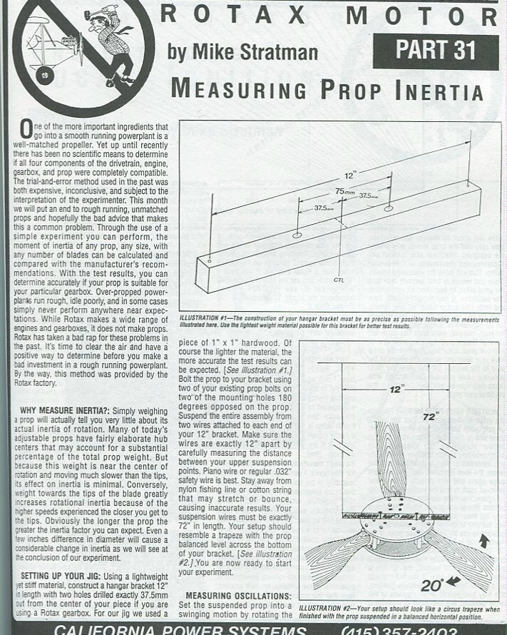

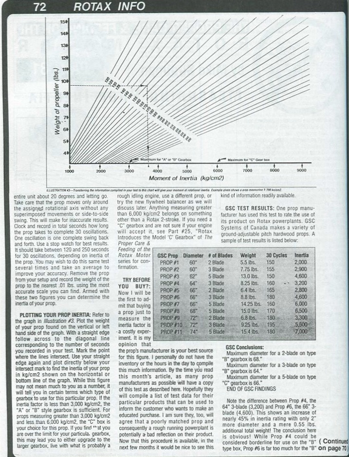

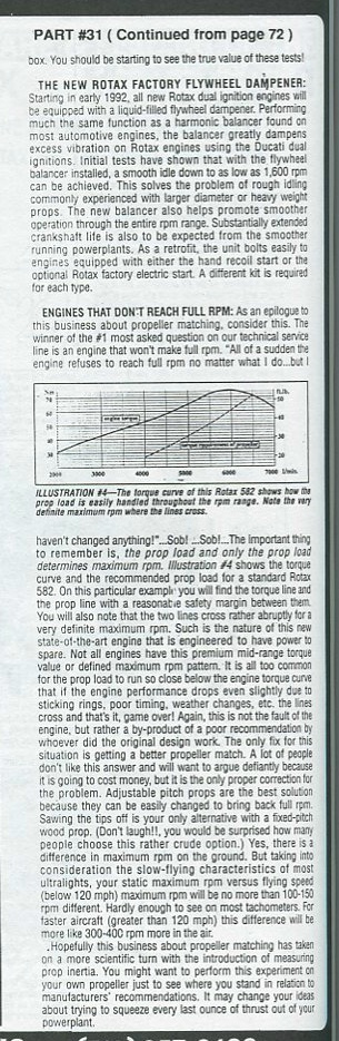

Years ago CPS had a complete series of tech articles in their catalog on Rotax engines and gearboxes and one of those articles was on prop inertia and how much the B box could handle. CPS currently has a number of those tech articles online but not all of them. I still have an old CPS catalog that includes all the old articles and this is the article on prop inertia, so I scanned it, perhaps it will be useful.
Also, since I am the list curmudgeon who gripes about ridiculously oversize pictures, and since I am not sure how big these pictures will turn out to be, I thought I better put it in a separate thread... Wink
