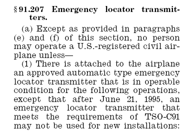

Are you seeing new 121.5/243Mhz ELTs for sale?
I think part 91 prohibits them as new installations
after 6-21-95 . . .
[img]cid:.0[/img]
Then there is the matter of just how useful the
older ELT will be in finding your wreck. See:
http://tinyurl.com/kz93ymy
