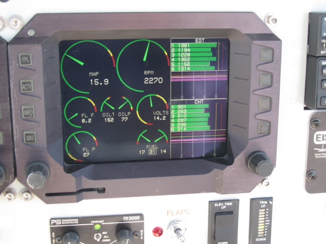

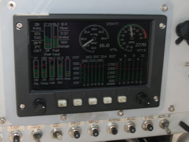

I have been operating LOP for six years and 837 hours. at 2500 pounds I routinely get 150KTAS at 55% and 9 gph. I have been asked "how fast does it go and I answer I don't know , I haven't been there". My CHTs at LOP run 275-320 and EGTs are all elow 1421. Be advised that the EGTS will rise aove 1420 and then fall off as you continue to lean. I use the lean function of the GRT avionics to lean and minitor.I start leani8ng shortly after I see the 25gph flow on TO.

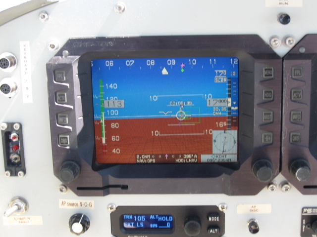

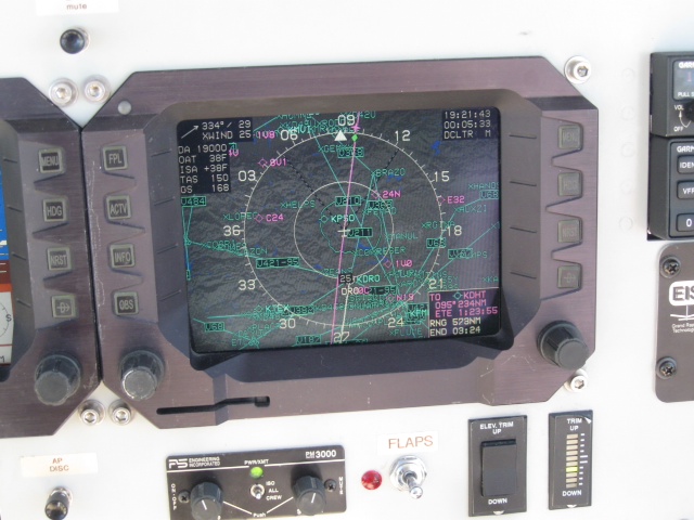

I don't know how to send pictures but here is a try. I was at 15000 KTRK to KDHT. At Cortez CO I was given a choice of the airway or 17000. These are the pictures at that time.
