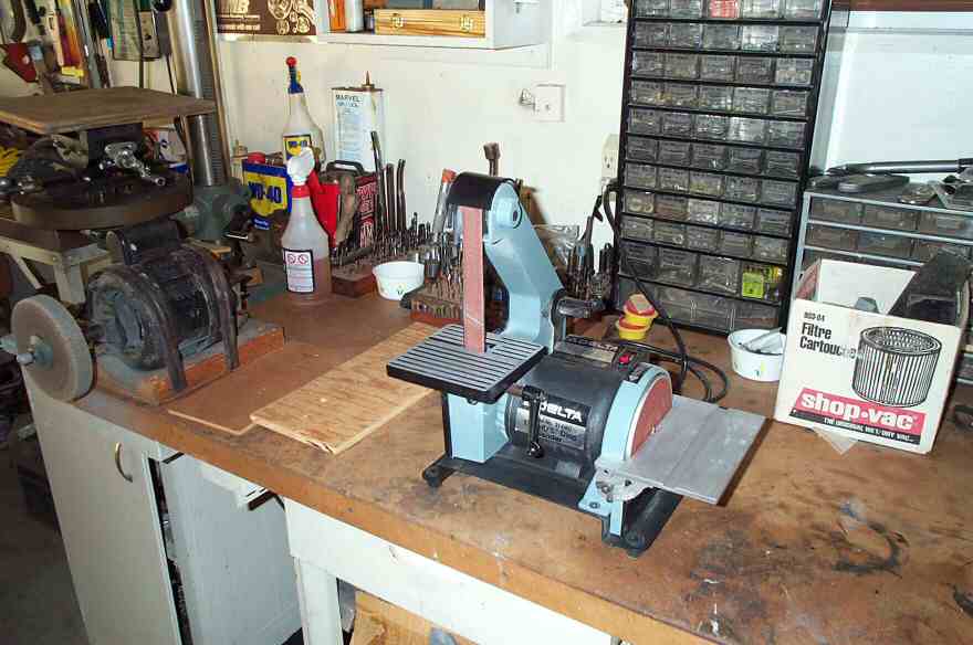

I have found this small belt/disk sander (pic attached) to be a useful tool for initial edge cleanup on the heaver stock such as spar caps and stiffeners. Cleans up edges nicely on fabricated pieces cut with a bandsaw. Used with a fine belt it is very easy to control material removal. I use the belt more than the disk. An edge deburr and then polish on the 3M unitized wheel leaves a finished edge.
Kevin
