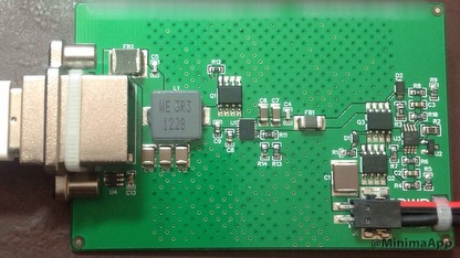

As I've mentioned a couple of times in the past, I'm working on just such a product. I admit that with the passage more than a year it probably looks like vapor-ware, but I'm getting close. As of about a month ago, I have a fully functional final prototype on my bench:
It has input over-voltage and reverse-voltage protection, output short circuit protection, USB device sensing so that it automatically configures itself to charge whatever you plug into it, noise filtering so that it plays well with other avionics, and it automatically shuts itself off when the aircraft's alternator is offline. It will rapid-charge two devices simultaneously (in this photo, the board was charging both my iPad 4 and iPhone 3GS). The board measures 3" x 2" (~76 x 51mm) and uses a rugged panel-mount dual USB receptacle.
Now I need to get production worked out. I'm a commuting airline guy, and I'm on reserve with minimum days off, so my time at home has been very limited. I have the second half of Aug off, so I'm hoping to make some real progress then. I can't promise a delivery date, but stay tuned...
