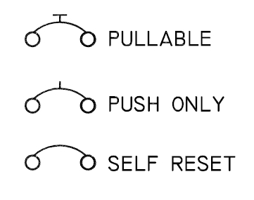

I've seen breakers depicted thusly on various
drawings over the years
[img]cid:.1[/img]
and all three of these pictures 'make sense'
when more than one style appears in the same
publication. It helps when either a table of
symbols or accompanying text speaks to
the existence of more than one style of breaker
in the system . . . but as Jeff points out, were
you to use ANY of the three to speak to the
ELECTRICAL functionality of any circuit breaker
in a schematic, no valuable information
is lost. Adding the little nuances to depict
MECHANICAL operation is just icing on the
cupcake.
Bottom line is, make a drawing that YOU
understand first but keeping in mind that
it may be useful that somebody else understands
it in the future.
