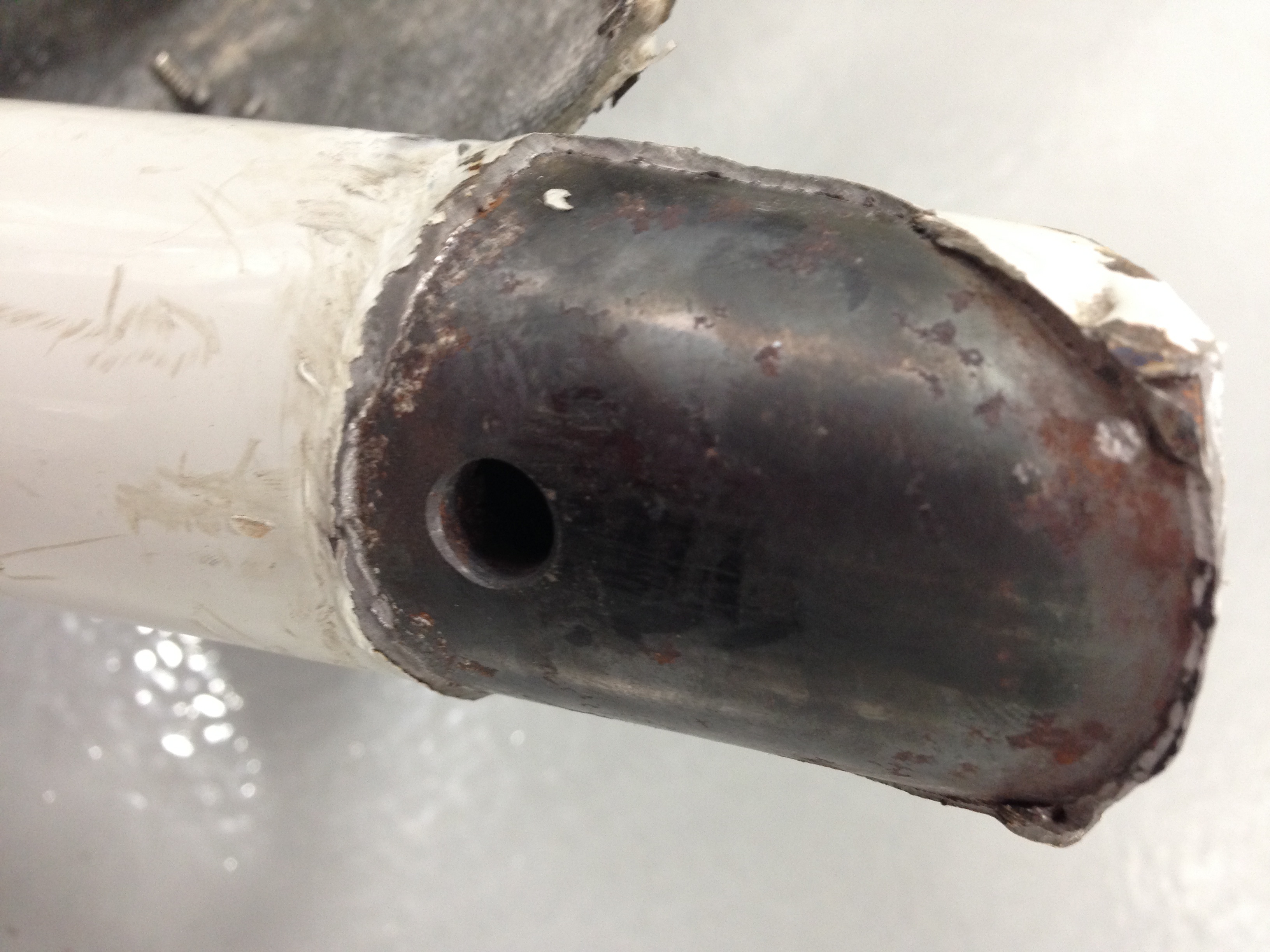

I'll give you my tail of woe!
Last Sunday I was making a routine landing at my home airport and on the rollout the nose gear departed the plane and then the gear strut stuck into the pavement and when the plane continued over it folded up underneath. It was a main gear landing at a slow speed. Prop strike, very badly mangled firewall where the nose gear strut cut into it, big gouge on left side where the nose wheel hit fusalage and then into the left flap. All at low speed. Gas everywhere. I was fortunate that it didn't roll over when the strut dug into the pavement. The insurance adjustor come out today and looked it over. His opinion agreed with me as to cause of accident. The gear strut broke at the weld where it attaches to the upright spindle on the wheel assembly. Looks to be a very poor weld and not a very robust design to boot. The weld  was very small in width and didn't penetrate very deep. Split right down the middle of the weld, I wonder how many ticking time bombs are out there ready to blow off the nose gears. Not in a place to check very often either.  Dan

I would like to examine my nose gear for the poor weld. I am not sure what weld you are talking about. Is a picture available? Thank you for speaking out on this issue.

The RV-10 and RV-8A nose gear leg are different.

It's where the nose gear leg meets the nose gear assembly.
 [img]cid:inlineImage0[/img]

In the pix I posted the wheel is to the left.

PostPosted: Wed Jul 23, 2014 1:57 pm    Post subject: Rusty RV-8 Steel Parts and other problems Reply with quote
As you can see the weld fillet is VERY small and the weld didn't penetrate very well.
From: jdriggs49(at)msn.com
Subject: RE: Rusty RV-8 Steel Parts and other problems
Date: Wed, 23 Jul 2014 14:52:28 -0500
