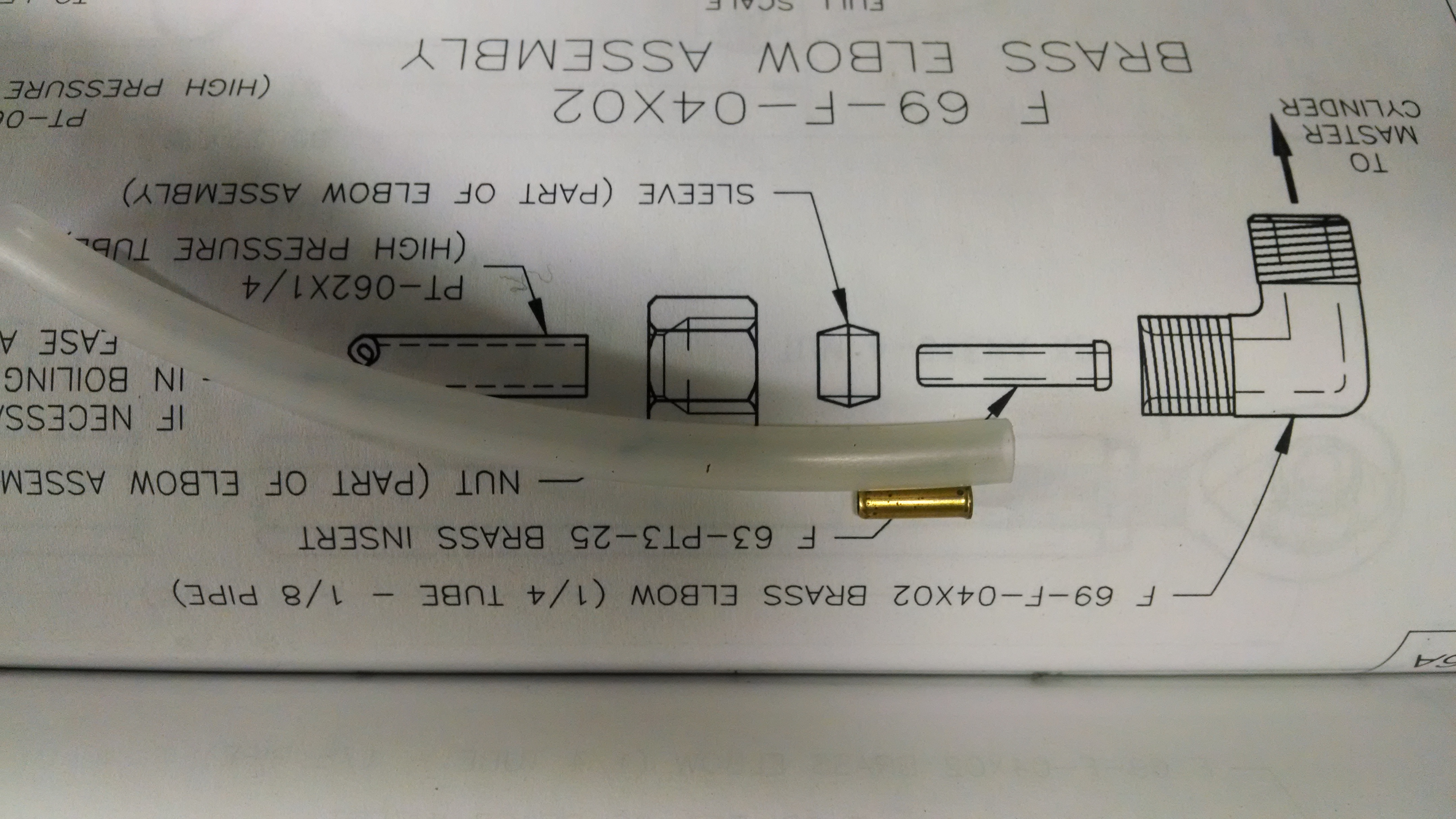

Hi List,
The brass inserts that come with my kit seem small. It went into my tube and won't stay in the brass elbow for the b-nut to secure it in place.
Advise?

Well, hard to tell from the picture ..... but the ferrule should fit a little snug in the tube .... if it falls out of the tube when you hold the tube upside down .... either the ferrule is too small or the tube too large. The sleeve should just fit over the tube. Ace has the ferrule .... and more tube .... in the aircraft isle, of course!!!
Linn

That is the wrong tube. Look for the ” tubing.
Carl

If you get the tubing from Vans, it will be .060" wall thickness and the inserts will fit it. The tubing you get locally is usually thinner wall.
Dan Hopper
