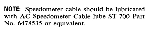

Checked the service manual for my '87 GMC
p/u. It says:
[img]cid:.0[/img]
In another GM service manual I found this
reference:
[img]cid:.1[/img]
Didn't find any specifics on the makeup of
this product but some inferences that it was
a special graphite bearing lubricant specific
to speedometer cables.

I have used powdered graphite to lube speedometer cables since the '70s
with good success. I'd check with the mfgr and see what they recommend.
