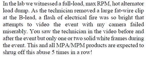

I do remember (scratch that; know from experience) that if the B-lead contactor opens while the alternator is under load, there can be a 'load dump' (high voltage spike) issue that can kill the electronics (the regulator) in the alternator. Makes sense.
Only on certain alternators that fall short of the-
best-we-know-how-to-do. Consider this excerpt from
the chapter 3 of the 'Connection
http://tinyurl.com/nchenmr
[img]cid:.0[/img]
But if the only way the B-lead contactor is allowed to open is due to an overvoltage fault, does it matter? Â At that point, it's a given that the regulator is already toast, and the entire alternator will be swapped out to fix it. Given the very high reliability of modern automotive alternators, and that the only time the B-lead contactor would need to open under load is during a true OV fault event, what's the compelling reason to keep the 'not recommended' philosophy?
Not a 'big deal' as you have deduced. The 'problem'
is rooted in legacy cockpit protocols that do
not prohibit turning off a loaded alternator.
You can do it in any TC aircraft without risk
of damage. You can do it in any aircraft fitted
with an alternator of the quality cited in the
narrative about MPA. But unlike the cookie-cutter
conformity control offered by the TC aircraft
world, we have no way to KNOW what quality of
alternator was being offered by Van's . . .
it seems that one or more of his customers
experienced a untimely demise of his alternator
by switching it on and off with the b-lead
contactor.
