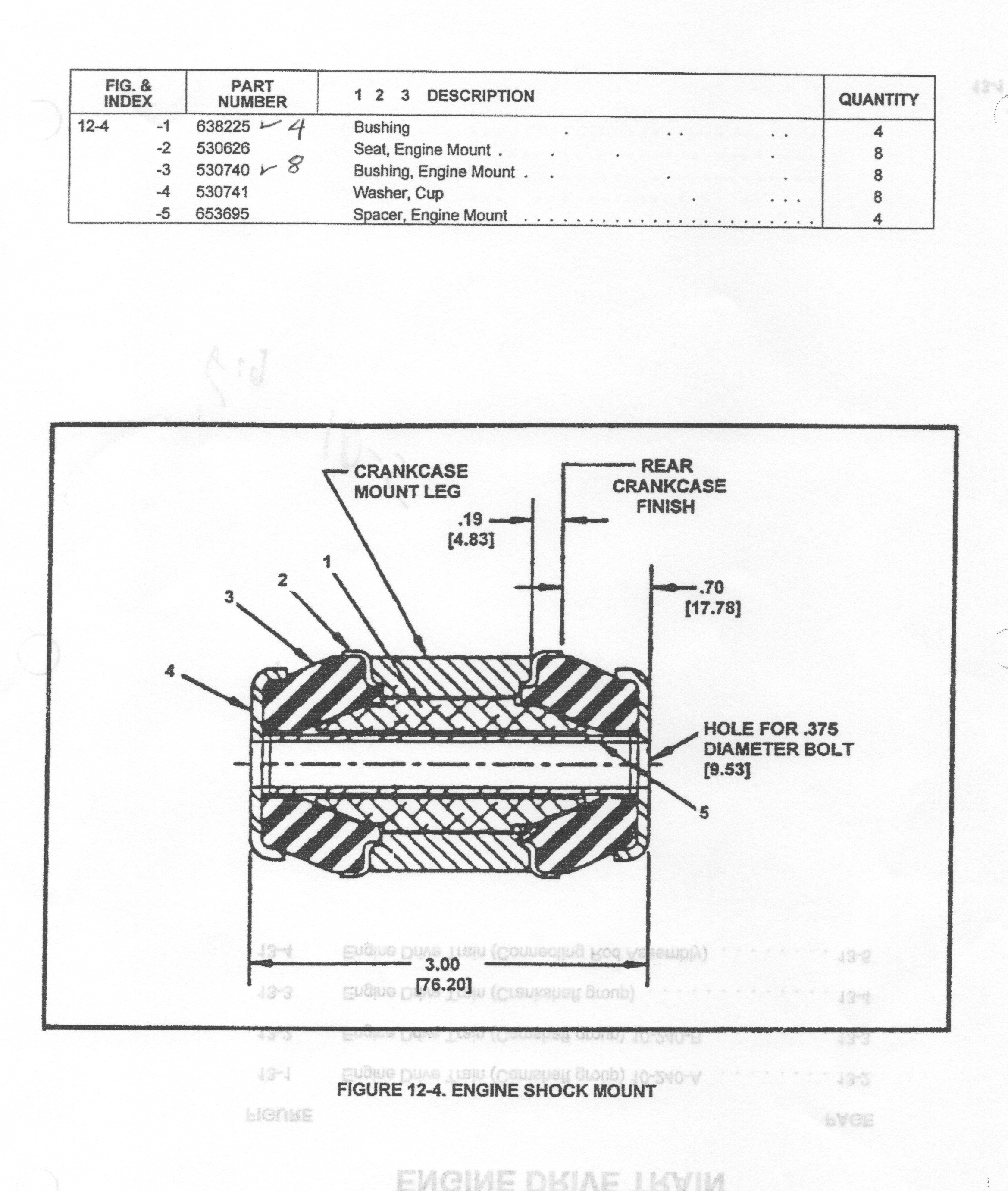

For those who have a Cont. IO-240 B1B in there TR-1 and haven't changed there rubber mount bushings recently, here are the part numbers and what they cost me from my source. Note that the four center bushings #638255 are not the same as used in the O-200. I had to remove my oil filter and adaptor in order the remove the bottom right mount bolt. The gasket was the replacement for the oil filter adaptor. If you have a different model IO-240 you may not need the gasket.
It is a bit of a chore but well worth the effort.
Thanks to OC Baker for his help no getting me the information I needed to complete this job.
Tim
