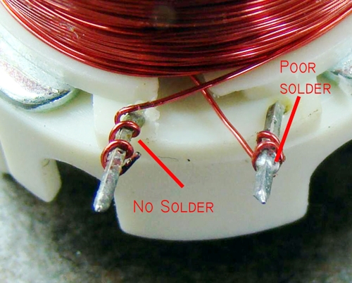

Were you to conduct laboratory reliability
testing for conditions in YOUR airplane, it's
unlikely that you would ever see a failure.
We HAVE seen some failures here on the List.
Detailed analysis revealed failure due to
a variety of reasons including manufacturing
defects
[img]cid:7.1.0.9.0.20140714094258.04cc69a8(at)aeroelectric.com.3[/img]
moisture ingress, and installation error . . . but in no
case were the failures first detected in flight.
