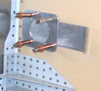

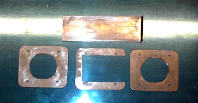

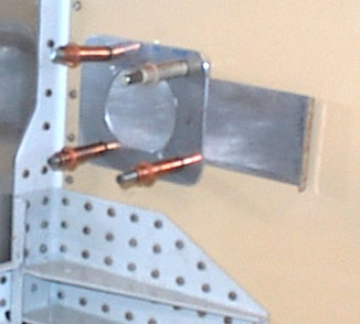

Current experience in my RV-9A indicated that my wife and I require different amounts of heat so I made a sliding cover for the heat vent that could be installed on either side. The sliding cover, at this point, is much longer than necessary as I’m thinking about how I want to control it. All the parts are made from .032” so the slide fits snugly and should not move due to vibration, etc. I’m thinking that once it’s set, it may not have to ever be readjusted so perhaps I’ll just shorten the slide and adjust it manually.
