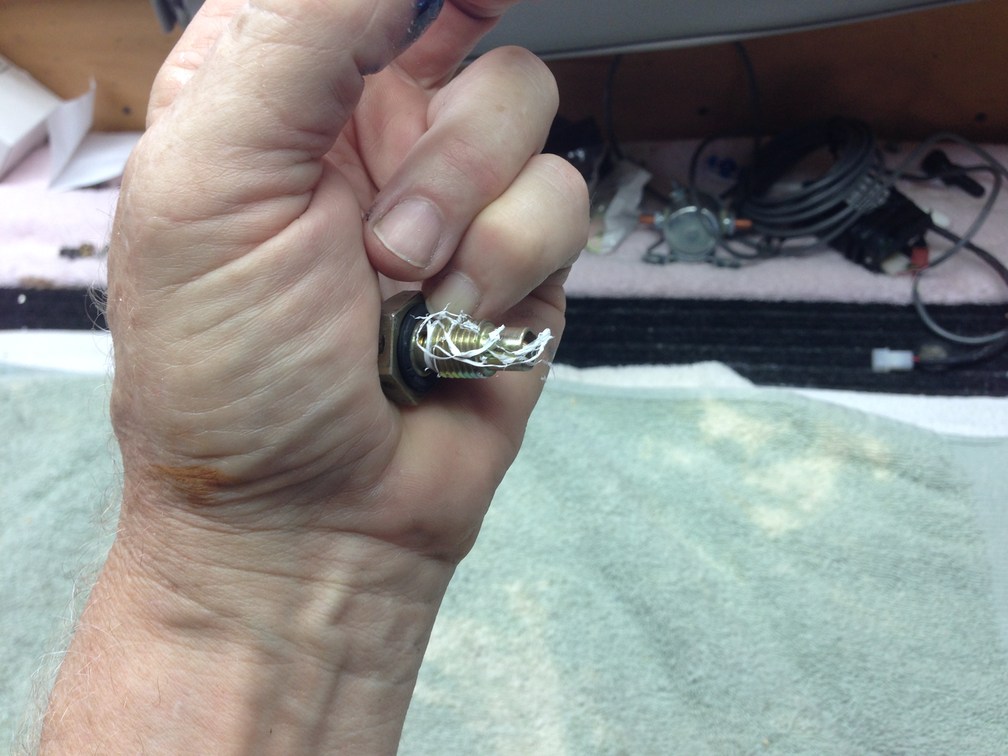

Fuel drain: Owner (new customer) comes in and wants me to fix leaking fuel drains. Both drains installed with Teflon tape. One was installed with fuel tank sealant. Upon removing the fuel drains, I noticed the surface of the wing. Dented on either side of the drain hole.  After removing the nutplate, I could see the inside of the wing had been scarred from over tightening the drain.

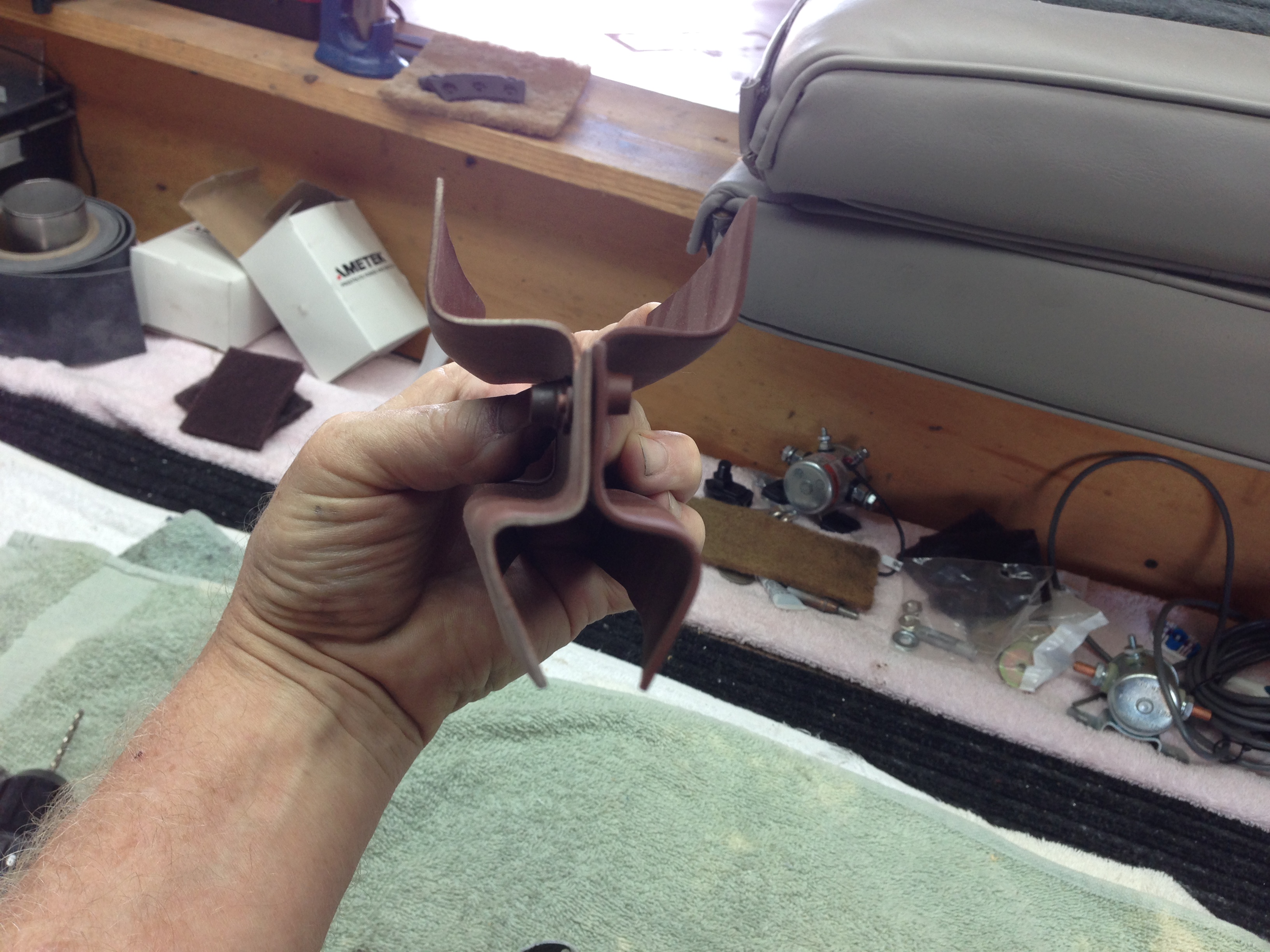

New nose gear side doublers/braces/brackets/whatever they're called with the nut plate for the nose gear fork obviously mounted about .1 inches off from each other.
