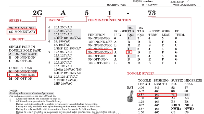

At 09:09 AM 7/4/2014, you wrote:
Hi Bob,
I'm searching for a two-position, momentary, DPDT, full size (panel mount, ideally with tab terminations but screws would be fine too) toggle switch and I have been unable to find one from Carling or others.
Do you know of a source? Is it in the Carling catalog and I'm just not seeing it? I'm having trouble believing it's not readily available but I'm just not seeing it...
The Carling catalog is a convoluted thing . . . but
yes . . . what you want is in there.
[img]cid:7.1.0.9.0.20140706105559.04d5c338(at)aeroelectric.com.0[/img]
The part number works out to be 6GL5B-73 which you can find in
the top item listed at:
http://tinyurl.com/qyb4ck8
They have 94 in stock
 Filesize:  200.37 KB
 Viewed:  5545 Time(s)

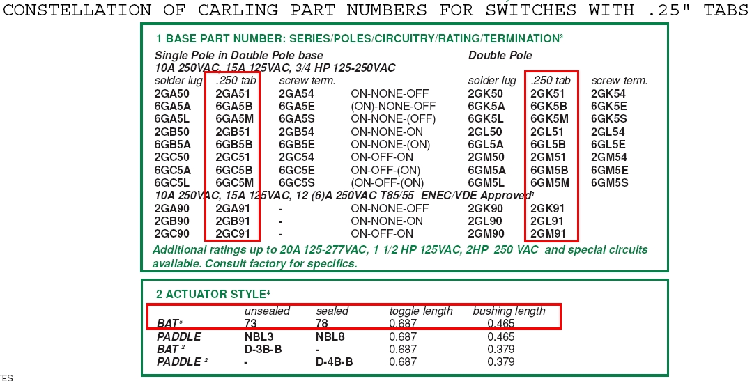

PostPosted: Sun Jul 06, 2014 2:33 pm    Post subject: My toggle switch quest... Reply with quote
Found this tabulation of Carling switches that makes it a bit
easier to identify a part number for our favorite series of
swtiches.
[img]cid:7.1.0.9.0.20140706173055.04e0d170(at)aeroelectric.com.1[/img]
 Filesize:  304.41 KB
 Viewed:  5539 Time(s)
