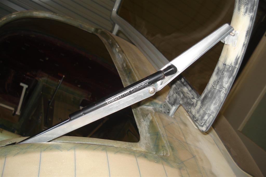

Fred Klein
Joined: 26 Mar 2012
Posts: 503
PostPosted: Tue Jul 01, 2014 6:41 am    Post subject: DOOR detached during flight Reply with quote
Robert Borger wrote:
Agreed. You could use cast iron hinges and they’d just tear up the fiberglass when the door departed. One must absolutely, positively, make sure both bolt shoots are in place. I have a strap attached to the inside lower rear corner of my doors that allows me to pull that corner in when I latch the door. I had microswitches for a while but they tended to get out of adjustment and wear causing false warnings. The strap is much better at confirming the rear shoots are in place and the door properly latched.
That sounds like a good idea Bob…
In my case, I added a tab of 1/8” Lastafoam w/ 2 layers BID, located per attached photo, on both doors. On the passenger side, I can reach the tab w/ my right arm extended behind the passenger’s head; I did not want to rely upon my passenger to ensure that the rear shoot bolt was engaged. On the pilot’s side, I cross my right arm over my chest to reach the tab. In both instances, I can both push out and pull inward, while engaging the latch as well as during final check list.
I was particularly concerned before installation of the door glazing because the lower rear corner of the door remained a tad proud prior to engaging the shoot bolts; I was a bit relieved when that disappeared after the weight of the glazing was added to the door.
Nonetheless, I’m installing microswitches for the rear bolts and will look for two green LEDs on the panel before TO…it’s a simple enough installation, thanks to Raimo Toivio, and I have no reason to doubt that it will be trouble-free…time will tell.
Regarding the hinges, I believe they were intentionally designed as the weak link in order to prevent damage to the FG of the airframe in the event of loss of door.
Fred
[img]cid:3507B4E6-530A-4180-8138-C1500D125DF5[/img]
 Filesize:  39.05 KB
 Viewed:  22350 Time(s)

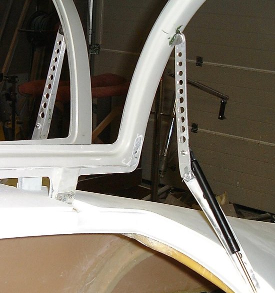

Ted Gladstone developed a door strut mod that works very well. See picture. Kingsley Hurst modified it and did a write up on the mod. I modified it further and installed it on my plane and it works very well. It takes virtually all stress off the door corner. Further info is on forum some time back. I have Kingsley's write up but he probably still has the info. Obviously the bottom line solution, as has been stated, always check for complete door closure before flight.
Bill McClellan
 Filesize:  231.03 KB
 Viewed:  22336 Time(s)

This is the best answer, also fit Mal McLure's center latch which stops the bolts engaging unless
the door is fully closed. It stops the door bowing out along the bottom rail in flight with the
ventilators fully open. It's very neat and very simple.
Best to persuade Kingsley to describe it. He has the original installed.
Graham
