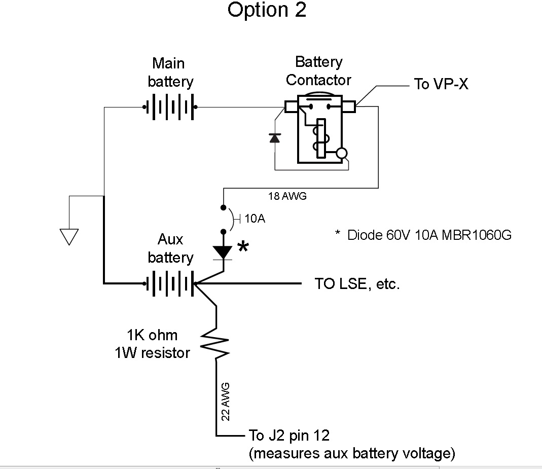

Because my last question was incredibly educational, I thought that I would try another. Very Happy
I'm thinking that I would like to have a brownout battery to keep the EFIS up during engine start. I thought about using a "deslumpifier" but figured that a brownout battery would have the added bonus of keeping the EFIS up during a... main battery failure, contactor failure, etc. (those not being the primary reason though).
My primary challenge is that I've got a 24v (or 28v if that's how you want to call it) electrical system and every auxiliary or backup battery that I've seen is 12v. But I found these:
http://www.monsterscooterparts.com/xt.html
or these:
http://www.monsterscooterparts.com/gr12vo45amph.html
Which would be wired in series.
I'm using a VPX-Pro and they support a backup battery and attached is the approach I was thinking of taking. The EFIS has multiple, diode protected power inputs so I would simply run one of the alternate power inputs to the backup battery.
Here's the question: Will they charge when wired as described? These batteries are lead acid batteries so given my limited knowledge of battery technology, it seems to me that it should work. I contacted the vendor and they would not comment beyond using the correct wall charger for these batteries. Attempting to charge them any other way will result in reversing the rotation of the planet and killing all life.
So given that, I'm not sure if this is the right battery.

What's your anticipated architecture? Under what
conditions do you anticipate a battery failure?
Yeah, you'll have to roll your own and you're
going to be loathe to install anything with
robustness . . . meaning small . . . meaning
not particularly long-lived when connected
across a DC bus system.
The deslumpifier is by far the more elegant
solution . . . with a Z-13/8 or similar
architecture and rudimentary preventative
maintenance, there's just no compelling driver
for bolting more boxes full of lead to your
airplane . . . even itty-bitty ones.
Not sure what you're looking for. Like I said, I'm running a VPX-Pro, 24v electrical system. I don't know how much more you need beyond the diagram I posted. Let me know, and I'll provide it.
Under what conditions do you anticipate a battery failure?
I don't anticipate a battery failure. My primary reason is to keep the EFIS during engine start. An added benefit is being able to power the EFIS in the event of a battery or contactor failure. The latter is just an added benefit. Not a primary reason.
Yeah, you'll have to roll your own and you're going to be loathe to install anything with robustness . . . meaning small . . . meaning not particularly long-lived when connected across a DC bus system.
Well, I was looking at 3-5ah (the EFIS and AHRS draw about 2a). So I certainly wasn't looking for cross-country endurance.
The deslumpifier is by far the more elegant solution . . . with a Z-13/8 or similar architecture and rudimentary preventative maintenance, there's just no compelling driver for bolting more boxes full of lead to your airplane . . . even itty-bitty ones.
Eric Jones provided me with a schematic for his DeSlumpifier a while back. But after thinking about the time to make the changes for a 24v system and build it, I thought that a backup battery option may be quicker and easier.

Ahhh. I think I see the confusion. This is basically a DeSlumpifier, right? I was thinking battery.
This is definitely an option. I'm at the point where I'm trying to avoid major detours. And building a DeSlumpifier from scratch could become a black hole of time.

Our information is that at least the GRT 24 volt version is Not 12-24 capable and suffers from low voltage reboot issues during engine cranking and for some during electric hydraulic pump actuation. We have solved their issues on a number of occasions using the 24 volt ips product.
Bob Newman.

If it's just brownout, and you have a 28V system...I'm guessing the EFIS will run on 12-28 volts, so I doubt you'll sag under 12 volts when cranking. Be fine won't it?
Tim
> http://forums.matronics.com/viewtopic.php?p=425412#425412
Tim
No. With GRT, you get either a 12v or a 24v version. The 24v version drops off at around 21v.
How long does this EFIS take to 'boot'?

[quote="nuckolls.bob(at)aeroelect"]
About 30 seconds. But it is also displaying engine data.
