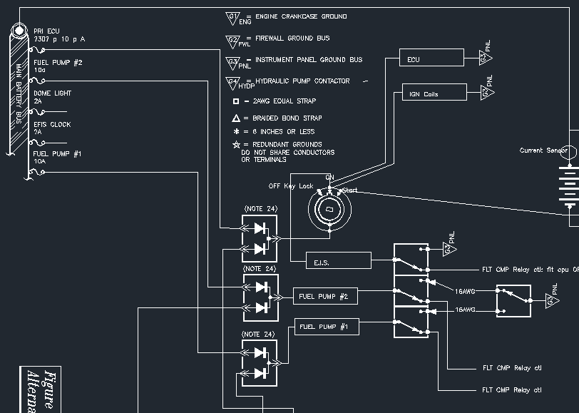

I wanted to have one for each device in case the device eat the diode or the diode eat itself ( I might get power for the diodes from the two regular busses as well instead of the battery busses but then that means I must have a relay energized with just battery power
Here’s a clip but I have attached pdf of what I have thus far on the layout….
p;
[img]cid:7.1.0.9.0.20140623075247.01f5dc18(at)aeroelectric.com.1[/img]
Okay. I'm thinking that your present 'state of the system' is
a bit over-complicated. The purpose of the diode pairs in Z-19
is to improve on reliability of available power to SINGULAR
critical loads. I.e. a single ECU has power available from
two sources which are isolated from each other by the diode
-OR- pair.
In your diagram you show two fuel pumps. There's no value in
providing multiple power sources for both pumps . . .
your stacking redundancies. Recommend you eliminate
the lower two diode pairs. Run one pump from engine bus
through what ever automated controls are available;
run second pump from main bus with its own, dedicated
on/off switch.
This leaves only one diode -OR- pair to boost power
source integrity for the ECU/IGN systems.
