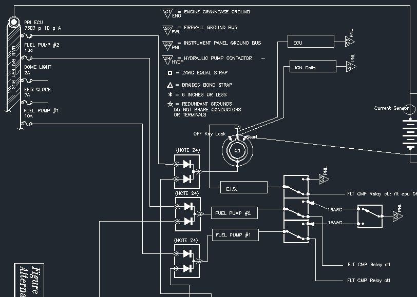

I wanted to have one for each device in case the device eat the diode or the diode eat itself ( I might get power for the diodes from the two regular busses as well instead of the battery busses but then that means I must have a relay energized with just battery power
Here’s a clip but I have attached pdf of what I have thus far on the layout….
