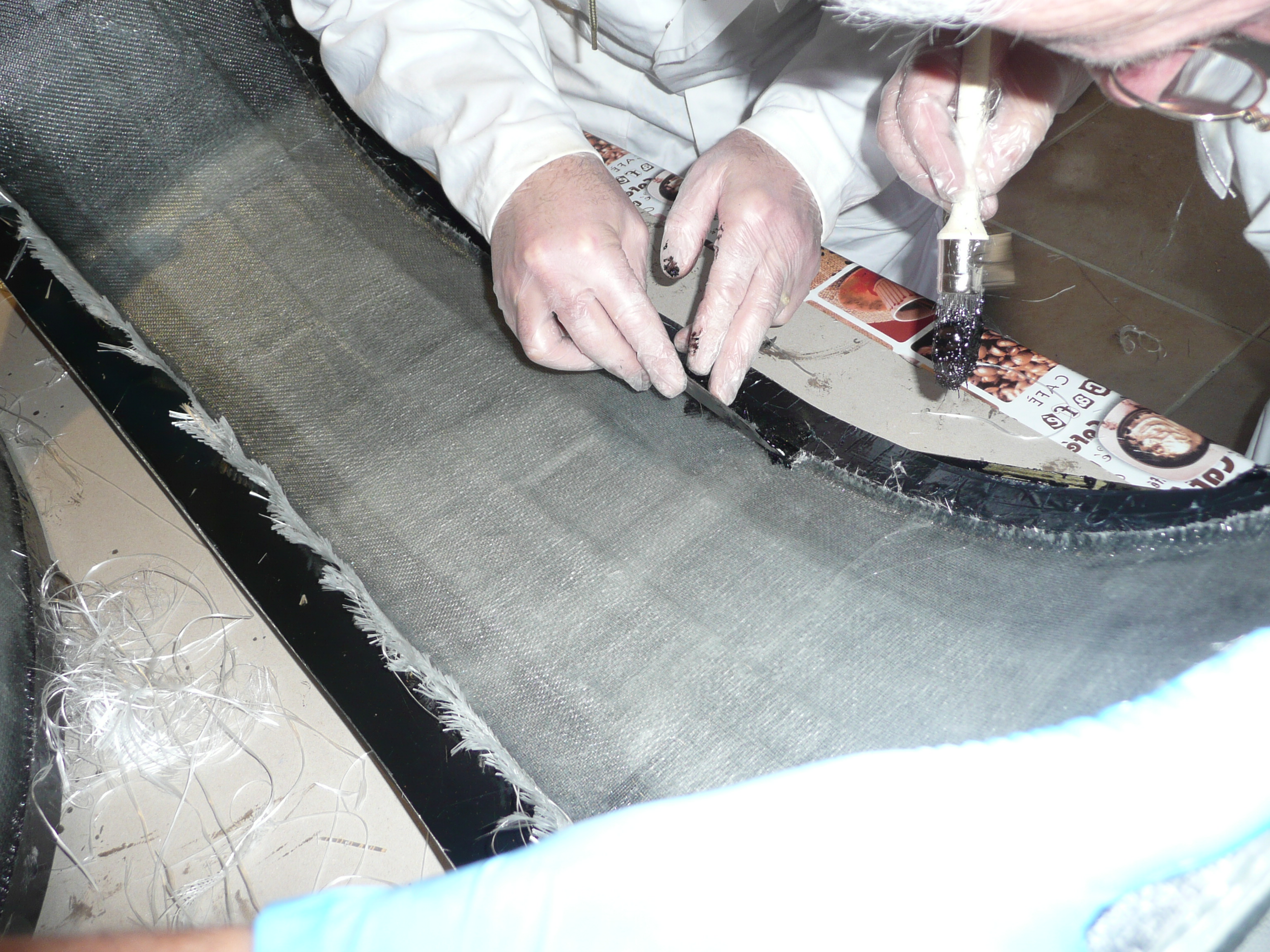

Hi all,

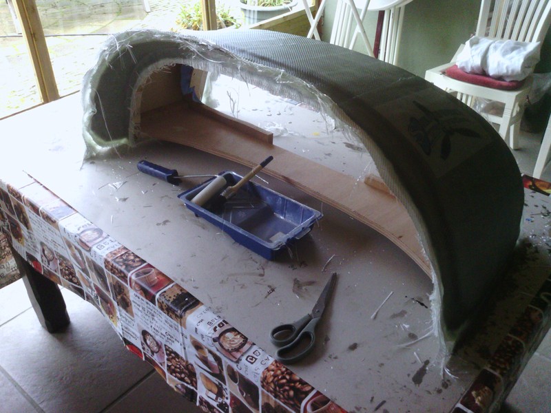

my friends built a new panel for me. Since most work is creating the negative form, we thought about selling it for a reasonable price to anyone who is interested - or especially has not reached this build status. The front panel can be customized to individual needs.
Attached you find the first pictures of it. It will be available after Chistmas.

Update: Asking Price is 750 EUR (650 GBP) plus VAT and shipping. A front Aluminium Panel is included as well - all ready to install, but without cutouts for instruments etc.. Since the panel is constructed for my Trigear, I cannot say yet, if it is in the way for the Monowheel flap handle, but will measure that on occasion.
The Panel can be produced within a few days by Spreuwenberg Techniek in Venlo in the Netherlands. He can do the cutouts as well if desired.
I will post some more photos in due course. What you see on the photos now is the negative form for the actual panel.

PostPosted: Tue Dec 31, 2013 1:12 am    Post subject: Re: New cockpit panel Reply with quote
Work at the Panel/negative form is still in progress by Spreuwenberg Tekniek in Venlo/The Netherlands, who is building it for my Trigear.
For those who asked me: I've measured and compared the distances from the Firewall and fuselage bottom between the old and the new panel and although there is more leg room etc. with the new Panel, it is probably necessary to cut out a Little space for the gear/flap lever of the Monowheel. Cutouts in the Aluminium front plate can be made by Spreuwenberg Tekniek as well, same applies for spraying etc. if desired.
More photos coming soon....

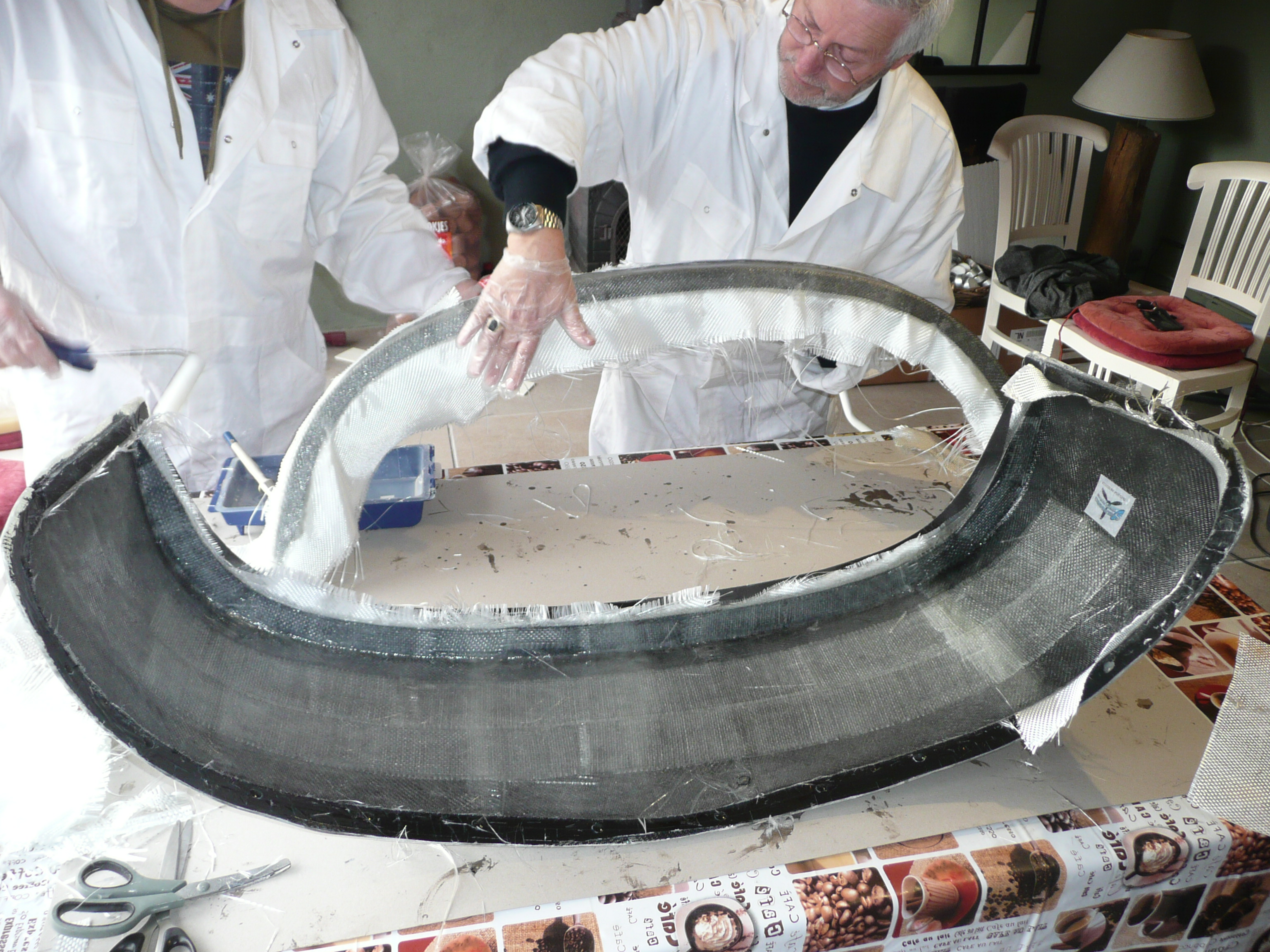

More photos....
Not quite in sequence Wink

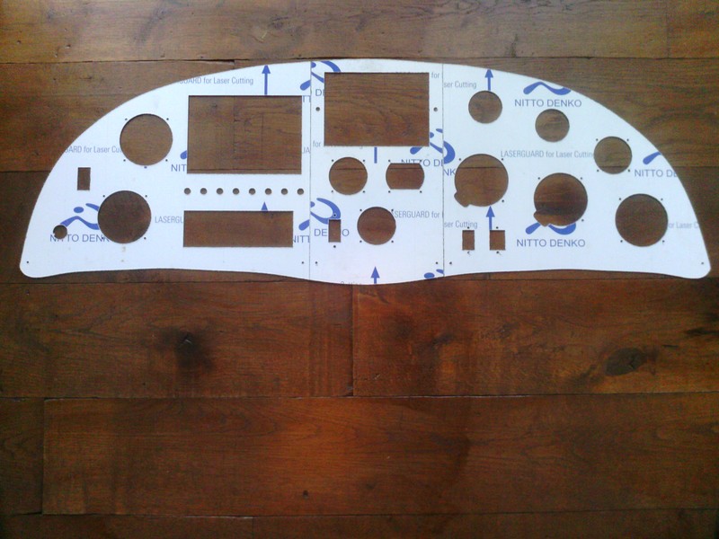

I'm also looking forward to see it completed. The CAD-drawings for the instrument cutouts from the Aluminium panel are also ready in the meantime. Of course I took the chance to make a whole new setup of the instruments following my own logic. An additional advantage for me (I'm 1,82 meters tall) is the added legroom. As color I'll choose a dark gray.
I have no idea to be honest, why the photos appear so huge (I find it best visible to reduce it to 40%).

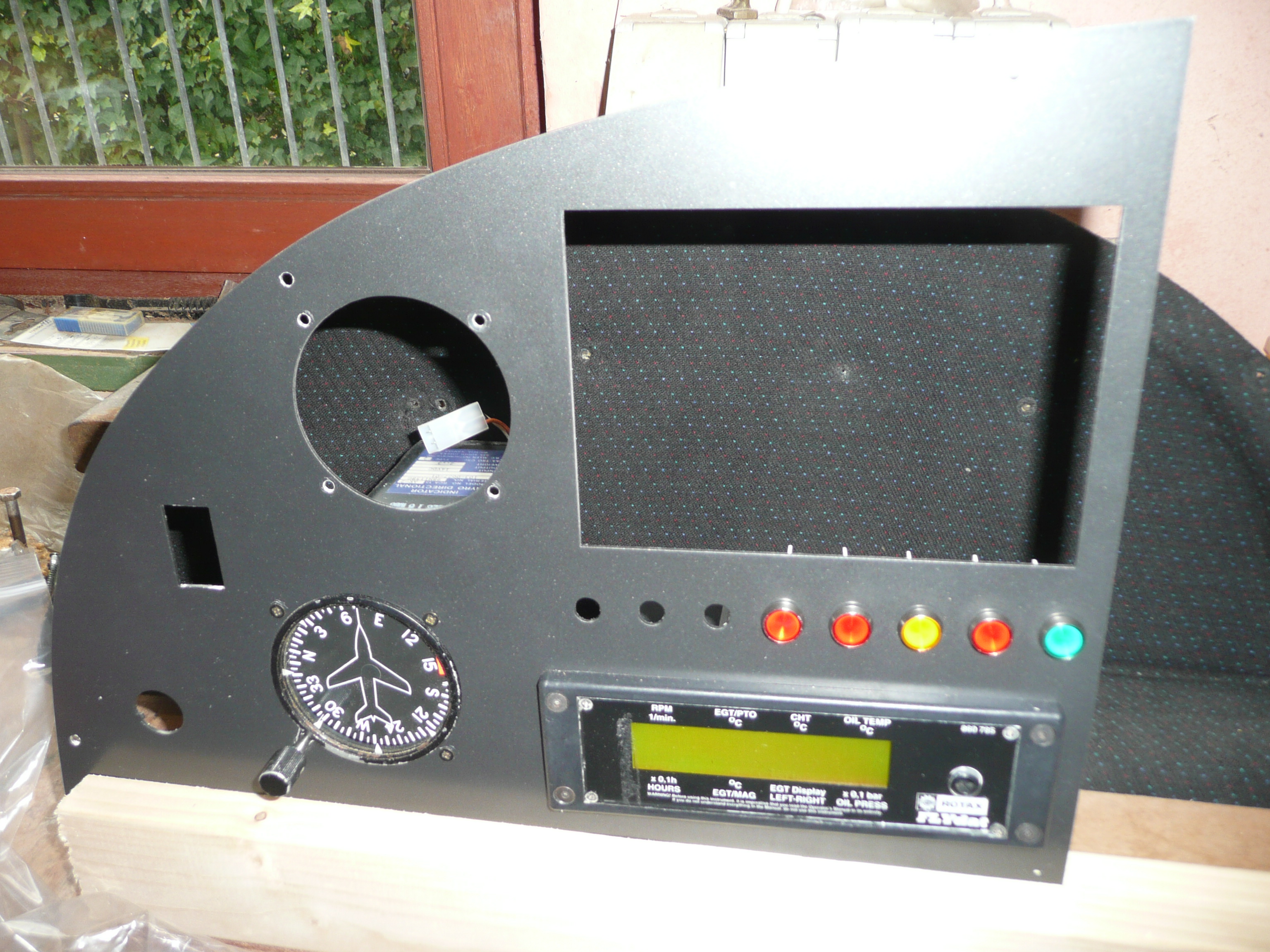

Front Panel (three parts aluminium) - will be sprayed matt anthracite. The large cutouts are for the Rotax Flydat, Skyforce GPS and Dynon D 60.
To be continued......

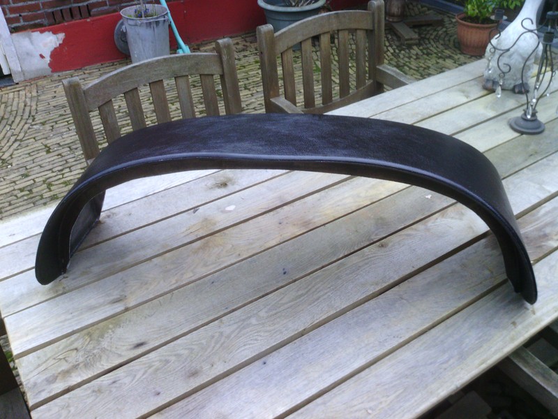

Believe it or not, the project goes on.....
BTW: a new set is already been made and ready for shipping Smile

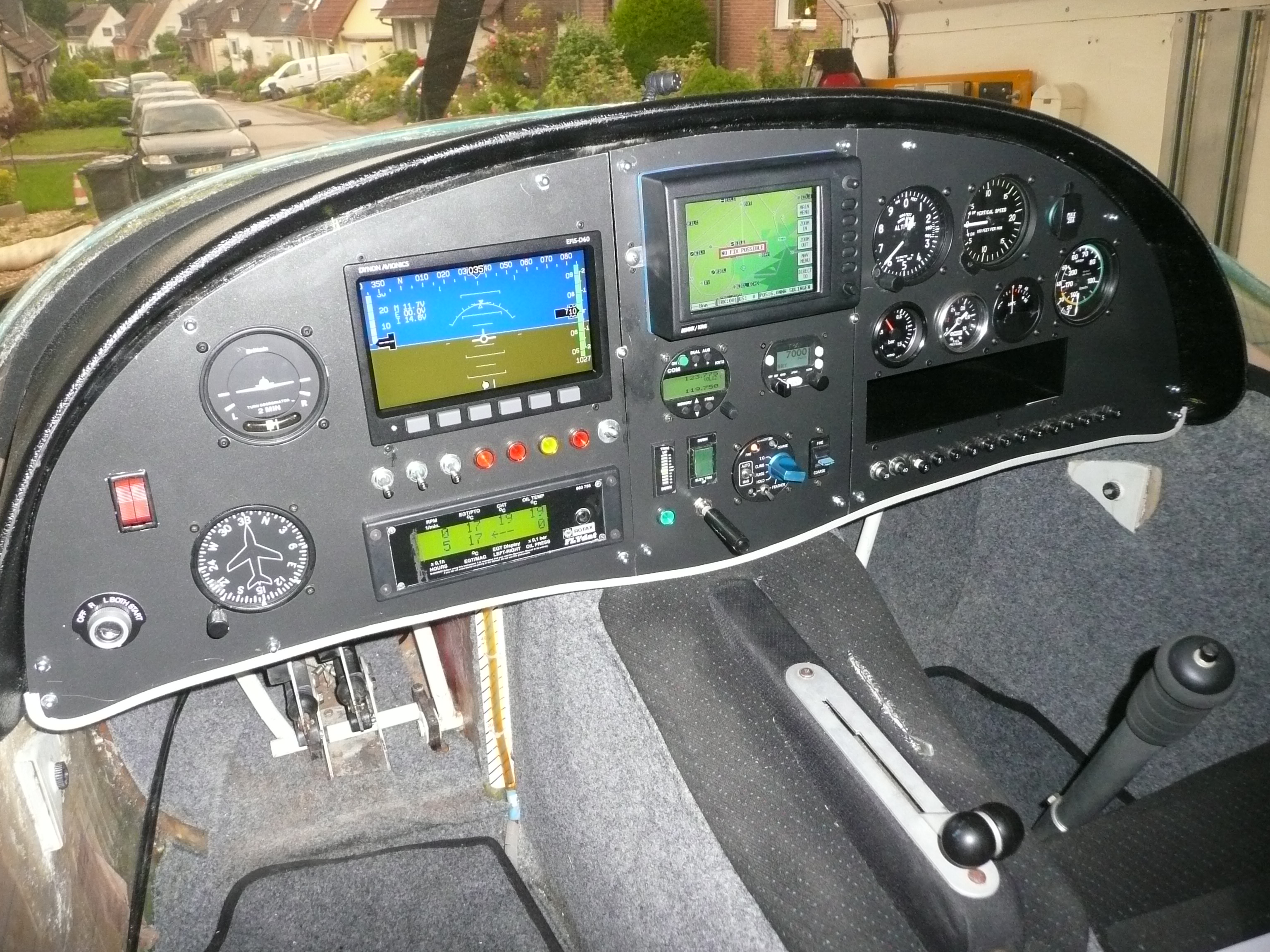

PostPosted: Tue Jun 17, 2014 12:17 pm    Post subject: Re: New cockpit panel Reply with quote
Hi Europa Folks,

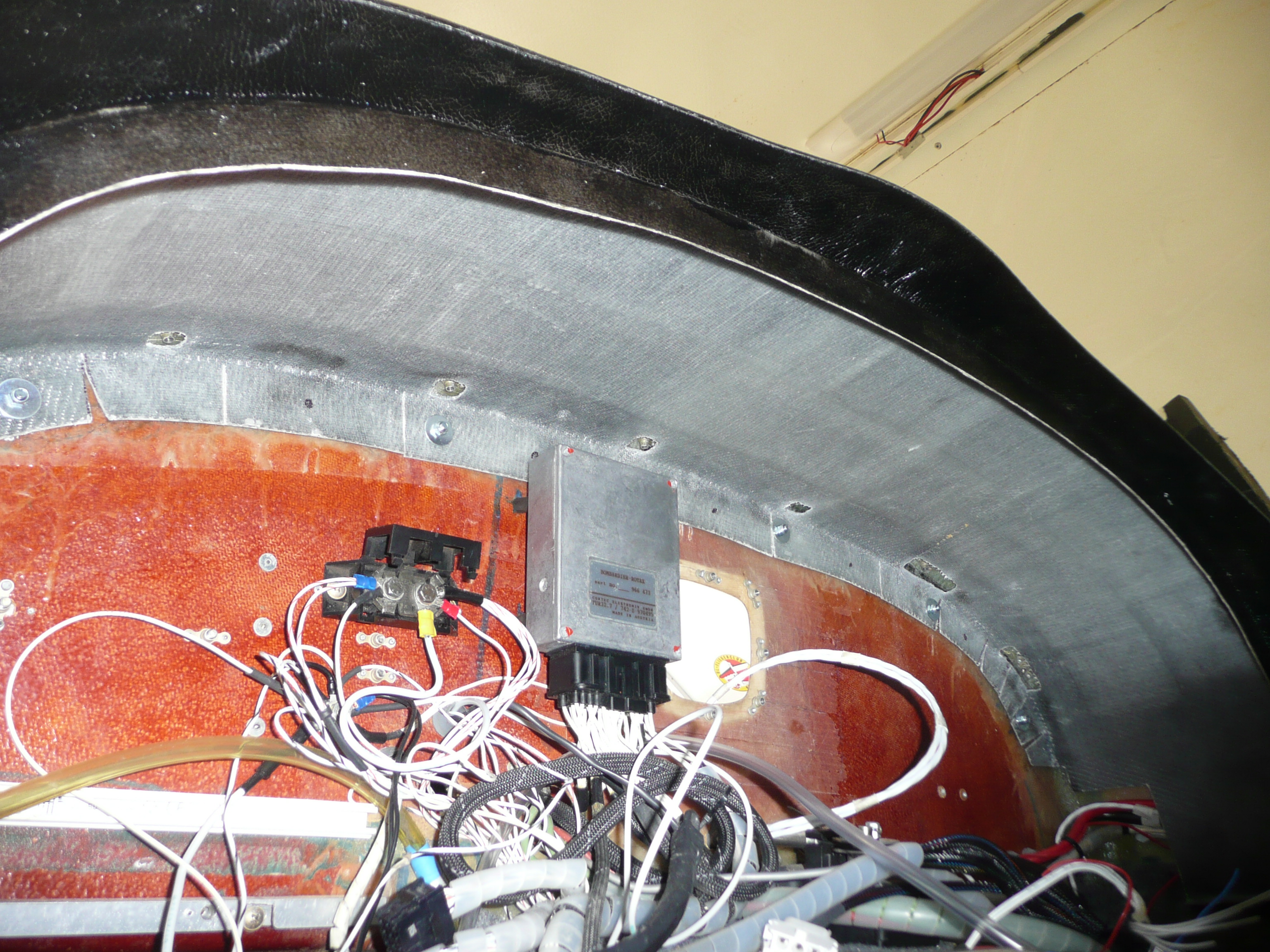

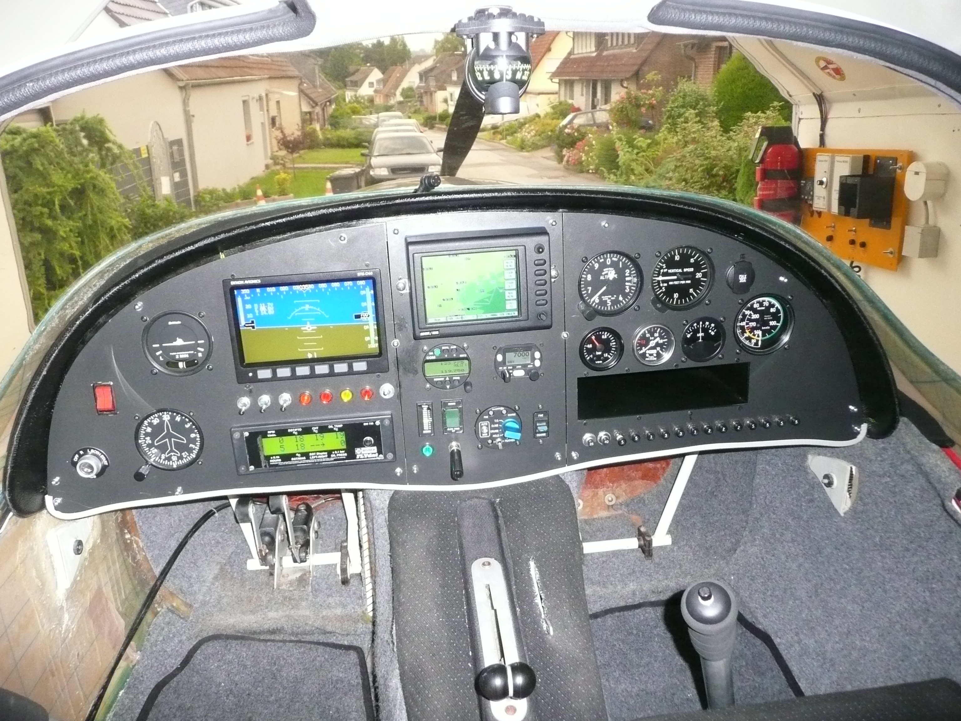

FINALLY - as promised I add some pictures of the ready Panel installed in my Europa.
You can see, that a little finish is yet to be done on carpets etc, but I think, that you can get a good Impression of the design.
I tried to get in contact with the LAA twice by e-mail in April to get some information of what they ask for a standard-MOD. Unfortunately I didn't get a response until today.
