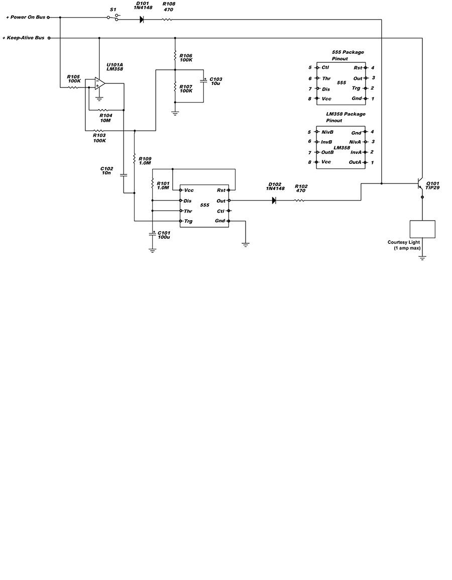

The July 2014 issue of Kitplanes Magazine has an article by Jim Weir describing a circuit to delay turning off a light after the master switch is shut off.
http://www.kitplanes.com/issues/31_7/builder_spotlight/aero_lectrics_july_2014_21035-1.html
There is no power wire connected to Vcc pin 8 of the 555 IC. Was a wire inadvertently left off or will the circuit work as drawn?

I checked the printed paper issue and the online issue and they are both incorrect. The 555 should be wired to Positive of the keep-alive bus. Likewise the op amp should be eliminated and a 0.01 uF capacitor installed in the trigger line.
It plain to see that Jim Weir loves op amps. I prefer simpler designs and hope to publish one here soon, using no ICs and only six basic parts. It will do a "slow-fade dim-out".
ps: it is entirely possible that the Cmos 555 will operate with no power connection. Cmos circuits are known to do that since their power requirements are almost zero. But I don't think it was done on purpose.
