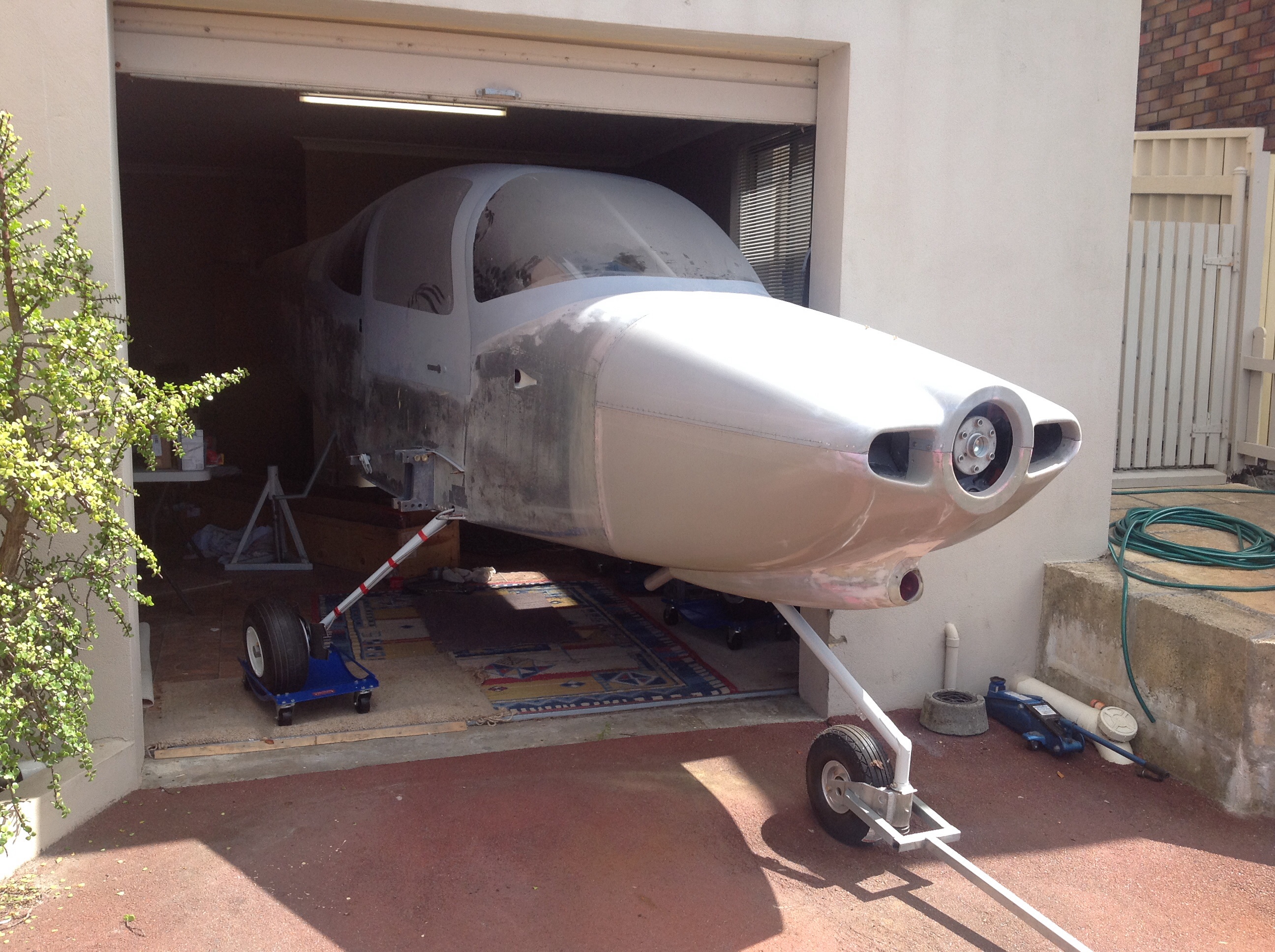

This is how I took 40389 out and back into a 94inch wide garage to trial fit wings/wing root fairings etc,.....sideways with 2 car dolly platforms with castor wheels. Cheers from Western Australia Laughing

PostPosted: Mon Jun 09, 2014 11:32 am    Post subject: Re: Garage door potentially too low Reply with quote
Brilliant work out in Oz Greg! Thanks for the photo. My problem was just to make sure the vertical clearance would be enough once I have the gear on. At 8'2", seems I'll be OK.
