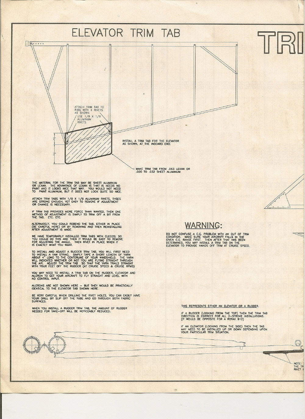

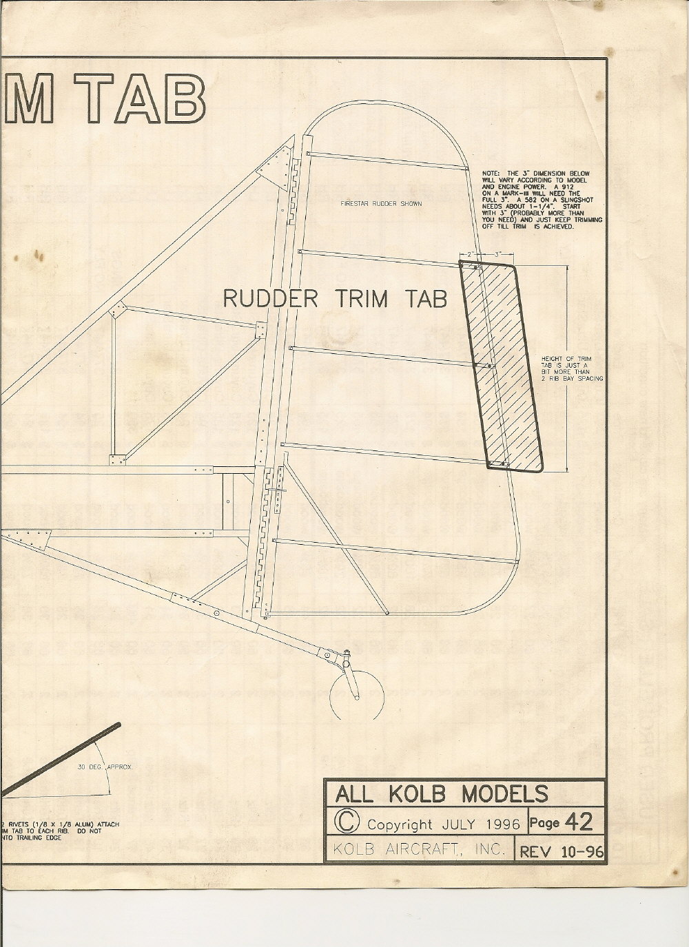

Trim tabs at 90 deg....  I don't understand,, tab deflected that far should stall and not work as needed..  or intended..   what is your toe in / out measurements?   Duo you know how to get accurate measurements?

I would take the trim tabs off of it, or at least bend them in line with the control surface. A trim tab at 90 degrees to the control surface is non-functional, and probably very counterproductive; you have no idea what it might do or what your results might be, but they would probably not be good. I would not consider flying an airplane with a trim tab at 90 degrees. All that tells you is that someone else had major trim problems with it, and didn't know what he was doing as he started trying to fix it, because a trim tab at 90 degrees is nothing but a spoiler. And since it is a spoiler mounted to a movable surface, all bets are off.

That seems to be the consensus of everyone who looks at the tabs, more drag than anything else. As for the toe in/out, no, not yet. Suggestions?

By chance, did those trim tabs get bent to that ridiculous angle during trailering??
Bend them straight with the control surface and see what it feels like, then start adjusting from there.....
JG
rowedenny
Joined: 09 Mar 2008
Posts: 338
Location: Western PA
PostPosted: Sat May 24, 2014 3:42 am    Post subject: Xtra Control Problems Reply with quote
Bingo John, but I'd bend them back to 15 to 30 degrees instead of going all the way straight, probably be in the ball park.

Brad, I posted the Kolb drawing for the recommended trim tabs recently. I've attached it to this post, too.What tail wheel do you have?
Brad
On May 22, 2014, at 21:43 , B Young <byoungplumbing(at)gmail.com (byoungplumbing(at)gmail.com)> wrote:
Boyd
