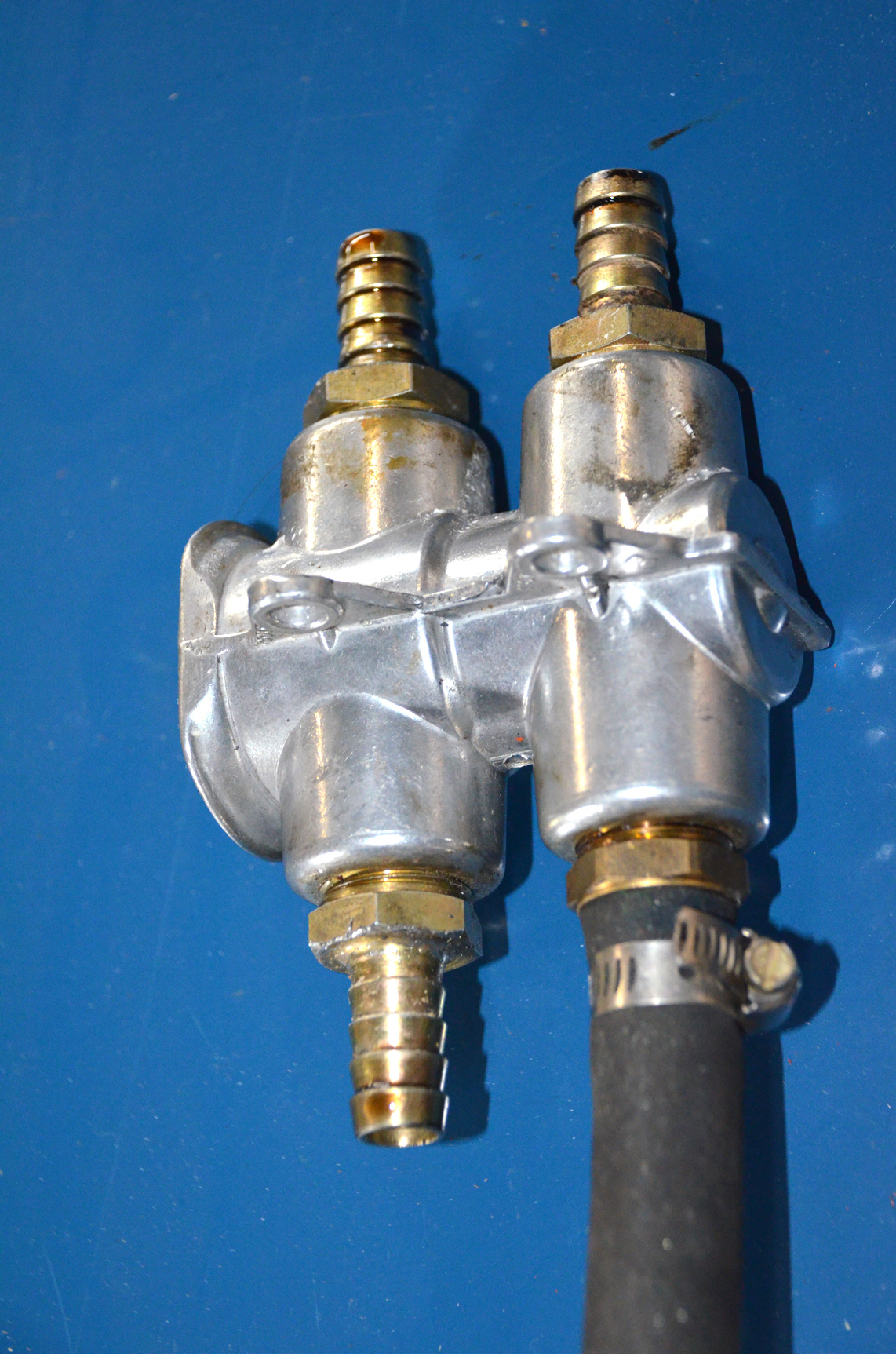

Hi Bill,
I send to you the thread to the website where I buy my oil thermostat.
He work perfectly.
You specified 25 mm outlet (it is easy to buy on commercial shop) in
your country
http://www.dream-machine.fr/store/com/combi-split-50-67/moteur-type2/circuit-d-huile-1/radiateurs-d-huile-et-accessoires-1/adaptateurs-1/thermostat-d-huile-tous-modeles.html
I join picture of mine
Good evening
Michel AUVRAY

combustion has already ended and because of the expanding space
temperature drops rapidly.
The fins on the barrels are misleading. They look like the fins on the
barrels of truly air cooled airplane engines, and make people think
that the Rotax engine is partially air cooled. This is not so. True, a
little bit of air helps to get rid of the residual heat of the
barrels, but not much can be gained by increasing air flow over them.
The barrels are also cooled by the cylinder heads and engine core. One
end is water cooled, the other end is oil cooled.
In my airplane I have closed off the gills AND the round openings at
the front of the cowling. Air flow is guided with two hoses from a
single opening which also feeds an oil radiator, and the air exits via
the cowl flap which is shared with the radiator exits and is usually
almost closed. With tuning the system I was amazed how little air flow
is needed to keep the barrels within a healthy temperature range.
In the original Europa setup, the rear most barrels have almost no air
cooling, without adverse effects.
Loss of coolant will almost certainly melt the engine. Although it
seems that while the engine is running the softening barrels and heads
will remain enough in shape by the pistons to keep power production up
fow quite a while.
Frans

<<<<<The barrels don't need to radiate much heat. Over 90% of the heat of
the combustion is transferred to the cylinder heads. >>>>>
This is confirmed by Rotax in the Installation Manuals:
They state: "The size and type of radiator should be adequate to transfer thermal energy of approx. 28kW (912S) 30kW (914)". For the cylinder barrel, they say: "the cooling air ducts must be designed such that they transfer thermal energy of approx. 6 kW. "
That means that up to 83 % of the cooling is done through the water-cooled heads. Obviously, in case of a total loss of coolant, the engine will not run for long with the remaining 17%.
Remi
