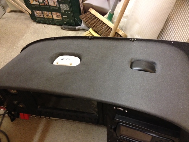

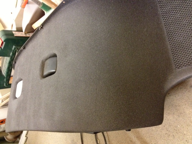

PostPosted: Mon Jun 02, 2014 4:59 am    Post subject: SkyYiew antenna Reply with quote
Hi Fred
I have got my gps module mounted into a recess on the tip of my instrument panel. I have also got my garmin 296 gps antenna mounted in a similar position.
I don't have any problems with them being mounted here or have any problems with them being located close to each other.
See photos attached showing mine incorporated into the top of my instrument panel.
Kind regards
Donald

PostPosted: Mon Jun 02, 2014 5:17 am    Post subject: SkyYiew antenna Reply with quote
Donald…thanks for the reassurance…and the pixs…very sweet installation…would love to see a pix of your panel itself…good luck w/ your test flying…Fred

anything on top of the panel that will give reflections.
Regards, David Joyce, G-XSDJ
