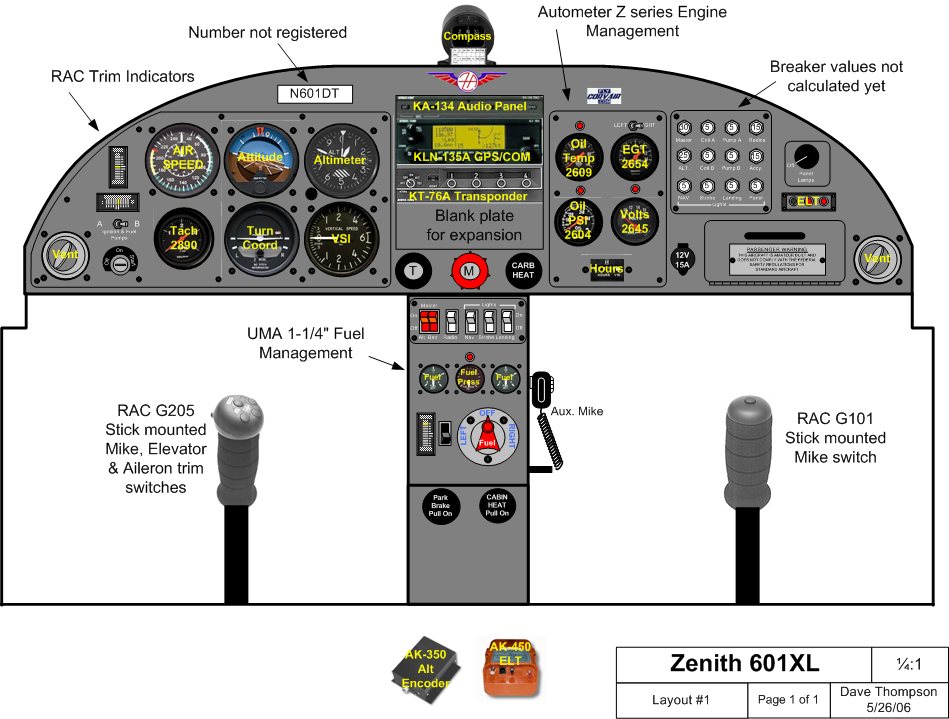

It’s cool that my guesses are very similar to what you have described. Attached for you Bob is one of my most favorite layouts for your entertainment and suggestions. I will post a photo-share for the other guys.  I drew it using Microsoft Visio. Anyone that wants a copy of my templates is welcome to them. The instruments are copied from websites which means that some of them may be copywrited. With this in mind, I will not sell them, I will only share them. The templates are also very large file sizes so they are too large to e-mail. If someone has an FTP server that is willing to host the templates, please let me know so I can make them available to whoever wants them. I have a great deal of other instruments & avionics templates not used in my plan, all divided by the manufacturer or type.

The way you young people can do things with a computer is absolutely fantastic. Your layout looks beautiful.
Of course, I would eliminate that Turn Coordinator and replace it with a Turn and Bank Instrument, but I guess that is what started this whole discussion!
Thank you for the very kind words and the picture of your proposed panel. Do you think you  could spread the altitude and airspeed out far enough to use a Dynon in lieu of the attitude gyro?
