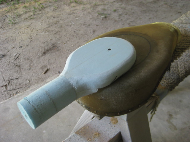

What timing!  Friday mornings the airport hangar rats gather to discuss aviation.  There's a -7 and two -10 builders.  Both the -7 builder and I (-10 if you don't do math well) were discussing the FAB and the connection to the lower cowl.  The subject turned to carb heat and alt. air.  I dislike the Van's approach to alt. air and we brainstormed .... how about a butterfly?  Hmmm.  I came home and this is what I came up with ....
if the picture comes through.
The Van's alt air fitting opening is 2.5" which has a 4.9" square area.
The 'plank' is 1" X 5" and the 'tube' is 2.5" dia.
I'll probably use aluminum for the tube.  ACS 6061 T6 03-38320 is only 4.35/ft.  We talked about the butterfly being an ellipse rather than a disk so it seals better.
There's plenty of room between the FAB and the lower cowl on the RV-10.  The 'dot' is centered on the hole in the FAB.  Some fillet work and I'll glass it right on the FAB.
Not an automatic alt air .... but better than Van's .... IMHO

Will it clear the nose gear strut?
Bob Turner
RV-10 QB
flying-nut(at)cfl.rr.com
PostPosted: Fri May 23, 2014 3:58 pm    Post subject: alt air Reply with quote
On 5/23/2014 7:48 PM, Bob Turner wrote:
Will it clear the nose gear strut? Even when you remove the lower cowl by dropping it down?
It's a long way to the nose strut ..... the end of the 'tube' in the pic
is only 5" aft of the FAB.
I could be flying if I didn't waste time on the 'simple' mods!!!
Linn

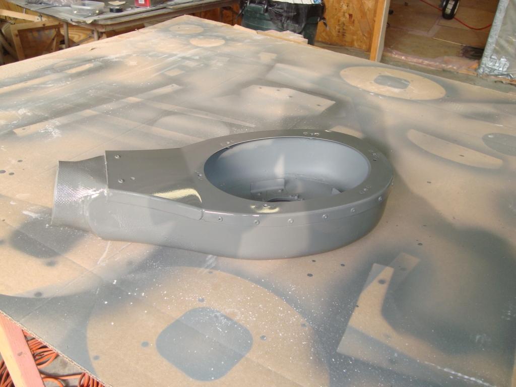

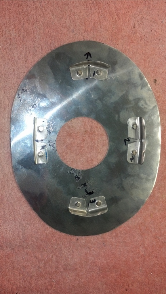

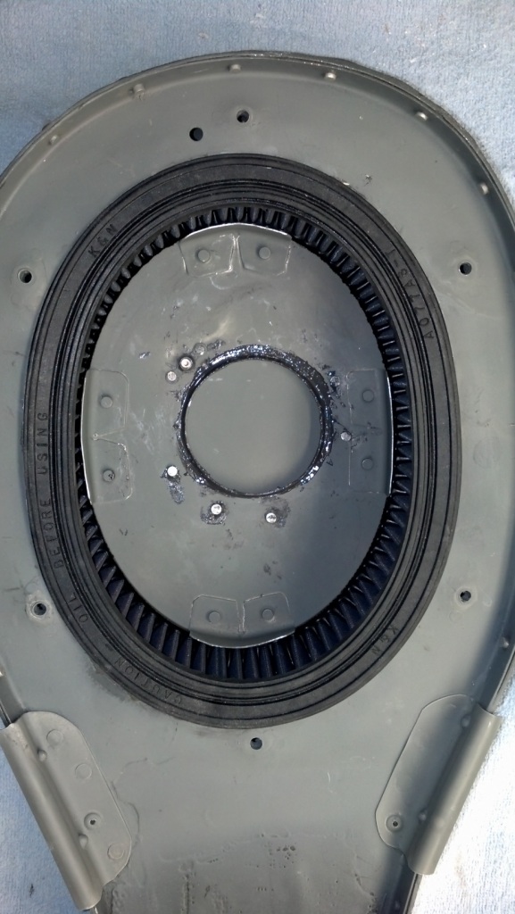

One thought – in all probability few of us will ever have a need to use alternate engine air. As such the design needs to be for something that opens, but closing can wait for landing if need be.
I posted a note a while back on modifying the FAB to prevent a recurring problem I had on the 8A, the filter ablating the bottom of the fiberglass air box and the filter deforming from a cylinder to a cone. Both issues lead to the filter loosing contact with the top plate. Here is the original post:
This is a mod to the air box I did on the RV-10, and just now back fitted onto the RV-8A.
Over the years with the RV-8A I’ve had to repair the air box and replace the filter. As you can see from the first photo, the bottom of the filter deforms (curves in). This tends to shorten the filter such that it drops out of the top and impairs the seal with the top plate. I also had to add fiberglass to the bottom of the air box as the relative motion between the bottom of the air filter the air box eroded away the fiberglass bottom.
The fix was to add a .032” aluminum plate to the bottom of the air box. The plate eliminates the bottom erosion and the added brackets hold the filter shape. A side benefit is that alternate air door now sandwiches the bottom fiberglass between two piece of metal making a sturdier install. I also took the step to add proseal between the aluminum plate and the air box bottom.
One other mod done for the RV-10 was to flip FAB top plate over so it goes over the fiberglass bottom portion. This allowed me to use the larger K&N E-1000 filter (last photo). I just finished the second annual on the RV10 and can report the filter has retained it shape.
Carl

That filter is ugly! I saw pics from other builders that were just as bad.
IMHO I think the 'deforming' of the filter may be due to the rubber on the filter having a problem with 100LL ..... or ethanol mogas .....
The filter just wasn't made for that environment.
I'm also adding a aluminum plate to the bottom of the FAB to counter the FG wearing by the filter .... saw some more ugly pics on this list. I'll add a drain hole next to the filter so it drips down into my 'new' alt air box.

The Mooney alt air is very easy to check for freedom to operate, just
push on the plate anytime lower cowling is open, or hook up a fish
scale to it when air filter is off to verify the tension is within
specs. The air pressure needed to open a given area of flat plate is
pretty easy to calculate. I've never found any problem with it
sticking when checking it. I like not needing to run an extra cable
through the firewall and not needing an extra knob some where on the
panel.

>> This is what I was trying to describe. If the attachment makes it
>> through.
> It did. Like you said, you don't know if it's going to work when you
> need it. Things get stuck with age. A round piece of rubber held in
> the middle would work similarly, but how thick/stiff does the rubber
> need to be ...... too much engineering for a simple guy like me. I
> like positive open/close.
> Linn
