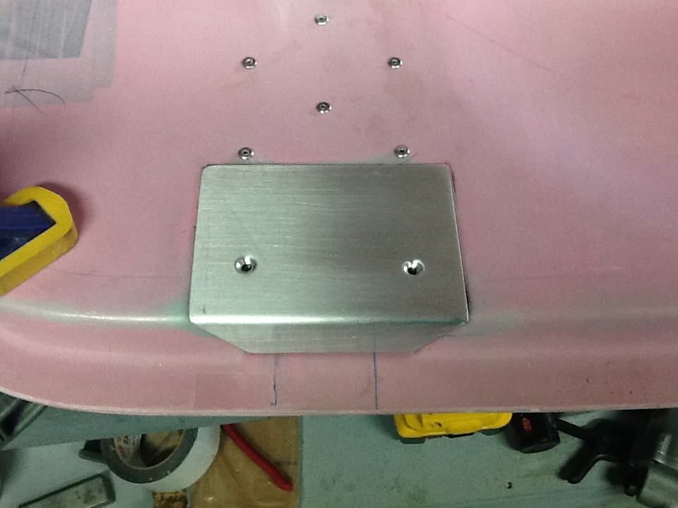

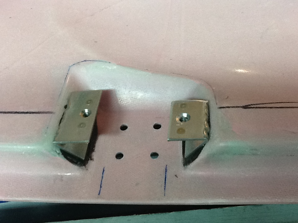

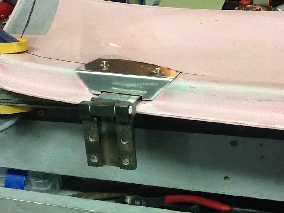

A friend of mine TIG welded some 3/4x.063 and I cut to length and added a nutplate and JB Welded each to the angle. I then made cover plates and finally slotted them for the hinge. Plenty of room to access all parts.
