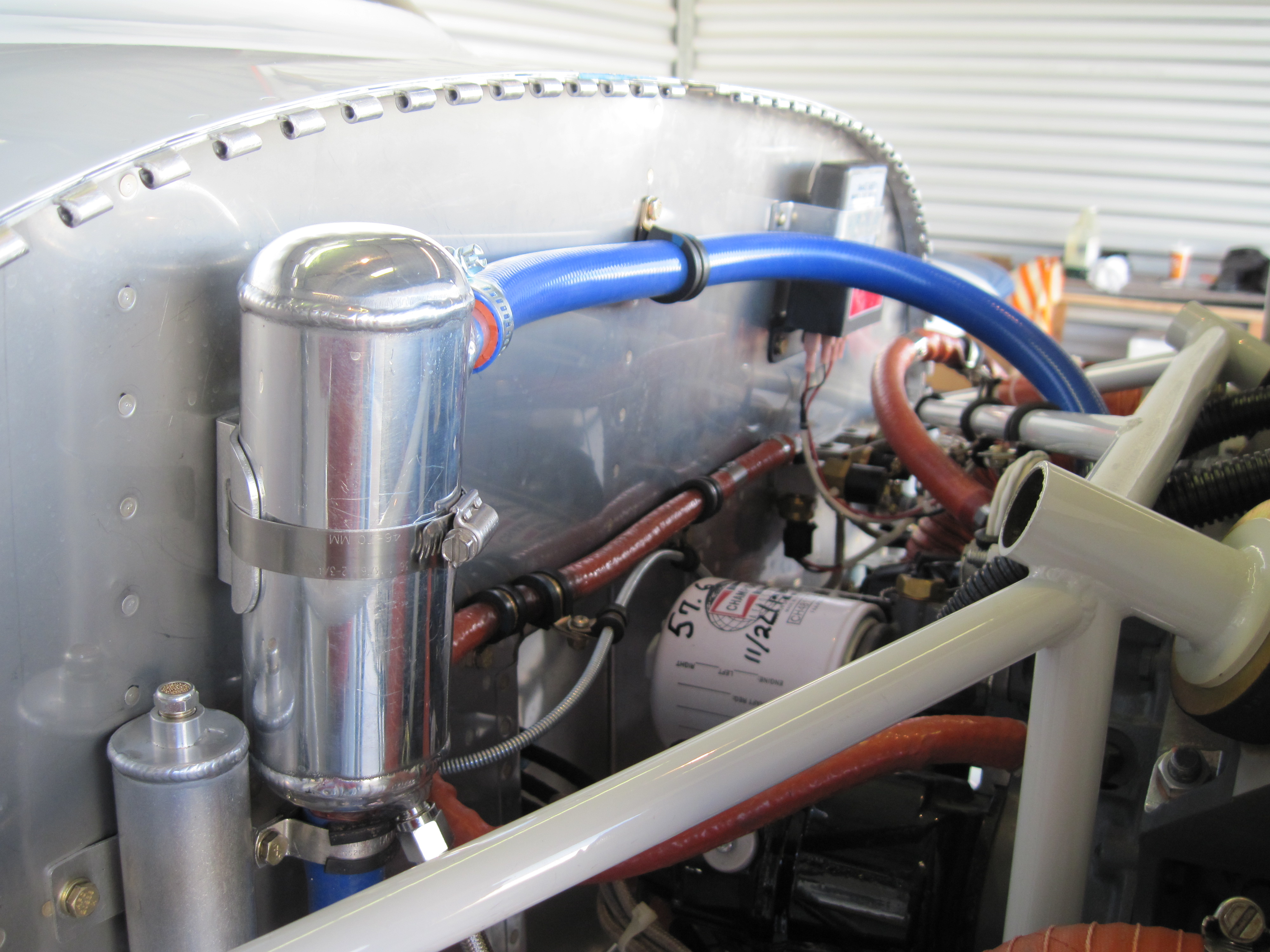

This is what I'm using. It works. I collect the oil - not return it to the engine. I empty out a couple of ounces each oil change.

 Filesize:  796 KB
 Viewed:  5781 Time(s)

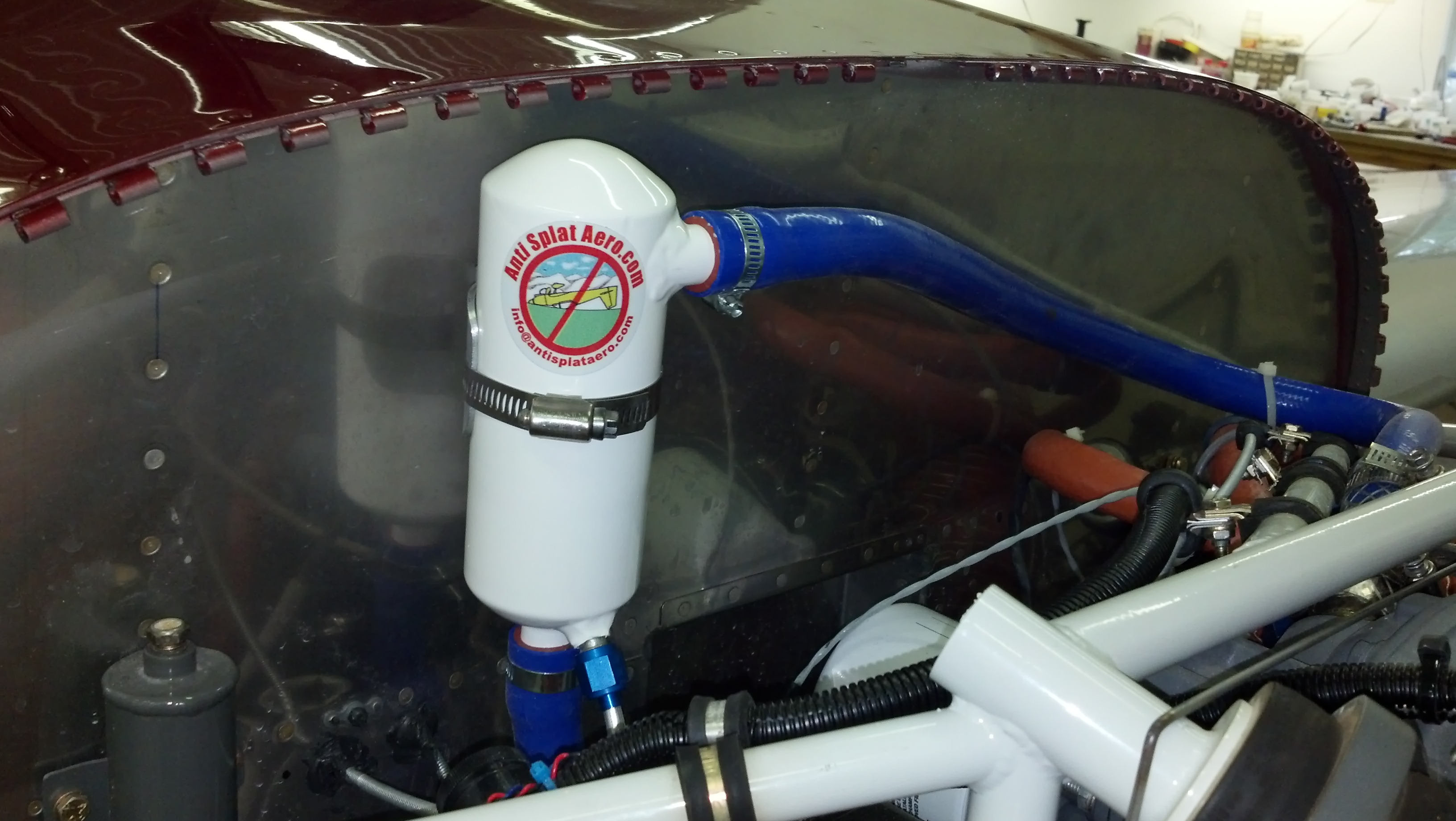

You might want to check out this thread on VAF that I started on Air oil sep and oil consumption http://www.vansairforce.com/community/showthread.php?t=92980. I have the Anti-splat A/O sep and am very happy with the results. If you mount it on the firewall, be sure to pick up either the cross brace, or support it in more than the two mounting tabs provided. The SS firewall is not thick enough to support the weight of the Separator on it's own. Here is another couple of threads on the subject of installation http://www.vansairforce.com/community/showthread.php?t=42386&highlight=air+oil+seperator, and a photo of my installation.
 Filesize:  2.04 MB
 Viewed:  5756 Time(s)
Bill

Did you also install the 'Anti-Splat' vacuum valve and exhaust port drain tube?

Yes, I installed the NAPA valve in the exhaust .
