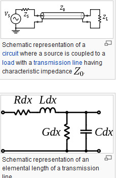

PostPosted: Sun Apr 27, 2014 4:24 pm    Post subject: Amp meter jumps when transmitting Reply with quote
Dj, John,
Here's what happens when a transmitter hurls RF energy down a transmission line. First, the transmission line has a characteristic impedance. Impedance is almost like a resistance except it's comprised of a mixture of capacitor reactance, inductive reactance and resistance. Reactances have currents and voltages that are 90 degrees out of phase. This means they don't "burn" up any of the energy, whereas resistance has voltage and current in phase and does burn up energy. Check out the attached picture from Wiki, which shows how the capacitance, inductance and resistances are modeled as lumped components. Ideally, the series and parallel resistances are zero. In practice they're not but designers try to minimize them to decrease attenuation.
When this energy traveling down the transmission line reaches the end, what happens?  If there's a resistor there that is equal to the transmission line's characteristic impedance, then ideally all of the energy is dissipated in that resistor as heat, since the voltage and current waves are in phase. If an antenna that is matched to the line is there, the power is magically transferred to the atmosphere, because the antenna's job is to match the impedance of the cable to free space impedance, which is 376 Ohms. It isn't really magic, at least mathematically, but one has to understand Maxwell's and Gaussian's laws to know how this happens and why free space impedance is 376 Ohms.
So let's say the end of the transmission line is open or doesn't match the impedance.  In the open case, the energy has nowhere to go except to be transmitted right back to where it came from. Let's say the transmitter's transistors are generating voltage waves that are 10V peak to peak. This means that the designer has to choose components that can handle this voltage plus some, say another 10V, in order to provide longevity and reliability.  When the reflected energy arrives at the transmitter output, the two waves (one going and one coming) can add up to a worst case number of 20V peak to peak if the phasing is correct. This comes very close to exceeding the design limitation of the transmitter transistors. If the designer specs the transistors to less than 20V, then the two added waves' peak voltage could very well destroy the transistors and/or other components. The designer could add transorbers or some other devices designed to limit the voltage build up at the transmitter to keep it from malfunctioning, but it's up to the designer and his design specs.
Also, the transmitter has an impedance of its own, and for maximum power transfer it should equal the line's impedance. When the reflected wave comes back, if there is a slight mismatch between the transmitter and line impedances, there will be some power dissipation at the transmitter but some of the power (wave) will reflect back to the end of the line. This means there are several waves on the line, but each reflection decreases in amplitude because of losses along the line and at the ends. All of these waves have to be added or subtracted to find the real voltages at the ends.
So the bottom line is can the transmitter handle the reflected waves such that when they add up, the end voltage doesn't damage the transmitter components, which of course have maximum voltage and power limits. I add power in there because power causes heat and components can only handle so much maximum temperature.
Hope this helps.
Henador Titzoff

PostPosted: Sun Apr 27, 2014 4:45 pm    Post subject: Amp meter jumps when transmitting Reply with quote
I'm aware of no supplier to aviation that does not
consider the rare but possible failure of a coax
connection . . . it's common practice to build
in protection, robustness or a combination of the
two.

PostPosted: Sun Apr 27, 2014 5:49 pm    Post subject: Amp meter jumps when transmitting Reply with quote
This is very true, Bob, but I would also like to add that the possibility of an open in the connectors and coax is more common than "rare." Most of these failures occur during build, which are accidental, corrosion or failure to tighten down connectors correctly.
While aviation suppliers will consider the rare but possible failure you mention below, there are several scenarios where this is not true. One scenario is the supplier receiving counterfeit parts that do not meet specs. Another scenario is a shady buyer ordering the wrong parts and a faulty lot is manufactured and shipped. Manufactured lots vary from lot to lot, and some lots may sneak through that do not meet specifications but work well until "something happens." In particular, this business of counterfeit parts has been plaguing manufacturing for at least two decades now.
Henador Titzoff

PostPosted: Mon Apr 28, 2014 12:26 pm    Post subject: Amp meter jumps when transmitting Reply with quote
You're right that I'm going down a road fraught with all sorts of relatively low risk items. Just trying to explain why an open transmission line might kill a transmitter that's otherwise designed to survive it. I hope my explanation of why the voltage could theoretically double at the transmitter helped explain to some how this phenomenon happens.
Henador Titzoff

PostPosted: Mon Apr 28, 2014 12:34 pm    Post subject: Amp meter jumps when transmitting Reply with quote
phenomenon happens.
Henador Titzoff
Your explanation helped me, and matched my limited understanding of how
it works, as well as allowing me to learn more.
Thank you! Smile
