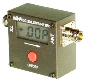

Do you have access to an antenna analyzer . . .
[img]cid:.0[/img]
or perhaps an SWR meter . . .
[img]cid:.1[/img]
The FIRST thing to do after checking the obvious (mechanical
connections) is to get some numbers. An antenna analyzer hooked
to the receiver end of the transmission line is the best
way to assess antenna health. Even use of an SWR meter
like the 'red dot' instruments off eBay can be excited with
the ship's comm transceiver (or a hand held) set to
the lowest comm frequency. The SWR should be relatively
low even though you're measuring at the top of it's
design range.
Put a dummy load
http://tinyurl.com/cchp3pf
at the antenna end of your VOR feed line, connect
the feedline to the transceiver and then "talk"
to it while monitoring SWR.
Alternatively, make a temporary connection of your
comm antenna into the VOR receiver input jack and
go fly the airplane. I'm betting that you're going
to see a marked improvement in VOR performance.
If your access to test equipment is limited,
you can play the swaptronics game . . . replace
the connectors on the ends of the feed line just
for the heck of it. It takes less time to do this
simple experiment than all the time spent thus
far looking for 'rate in the woodpile'.
