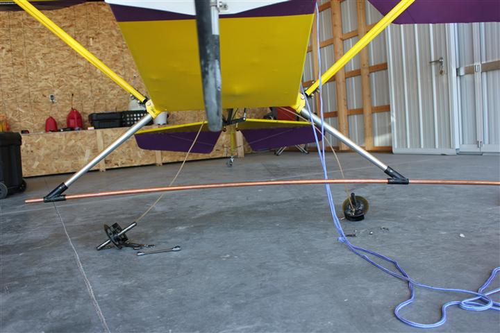

Here's a means that we found for easily aligning the landing gear on a FireFly.
Pretty self-explanatory....
The hard-drawn copper pipe fits exactly through where the axles go.
JG

I had attached a photo to that post, which shows up in my sent mail, but doesn't appear in the post for some reason????
Anyhow, it's just a matter of removing both axles, and sliding a length of 1/2" hard-drawn copper pipe through from one side to the other. There's enough flexibility in the pipe to handle the camber angles of the axles.  The pipe locks both gear legs to a straight ahead position, or by forcing the center of the pipe a bit back you can set for a slight toe-in, equal on both sides.

Picture came through fine for me.

The picture showed up here JG.Easy way to do it except for the 200.00 dollars worth of copper tubing.

I just purchased a used Firefly with some damage to the cage and fiberglass nosecone. What is the bar in the picture? Is that some kind of protection for the nose if it goes over? what is it attached to?

Right on. So go to Lowe's, buy a 5/8" grounding rod and use it, it's what I used on the MKIII years ago, since the MKIII has 5/8" axles, and I expect the FS does too. When you get done, take it back to Lowe's for a refund.

I liked the straight edge behind the wheels and the carpenter square along the side.  Seems more accurate than the axle method

I was not refering to the horizontal grounding bar but the verticle tube in the foreground. is this to protect the front in case of a noseover?

The U-shaped tube under the nose was reportedly installed by some builders
to keep the machine from going up on the nose
if mishandled...repeat MISHANDLED. It does not appear on my 1998 factory
Fire Fly plans and, near as I can tell, is not mentioned in the factory
building manual for the Fly as it was sent to me at that time. There is no
such U-tube device on my Fly.
IMHO, if the would-be Fly aviator applies the throttle gradually on takeoff,
uses average to good tail wheel technique, and refrains from stomping on the
brakes while in motion, the U-tube is not required for normal Fly operation.
As I recall, I have never seen it installed on any Fire Fly I have
personally observed. I have no clue about what it was connected to when it
was installed, or how well it did, or did not, work.

Thanks for the reply! As I have been working to repair the fiberglass nose cone obviously cracked up from a noseover it looked like something that belonged there.

If you are referring to the bow which appears under the nose of some
Kolbs,forget it. In theory it stops the plane standing on its nose. In
practice, if you have got things wrong the nose will be yawing anyway and
the bow will be laid flat. Ask me how I know.
Just ensure that the stick is RIGHT BACK when you taxi, and open the
throttle gently.

So... Maybe I need to stop at Northern Tool and pick up one of the big casters with a 4 inch inflatable tire? OK I'll try easy on the throttle when I get this thing back together.

Brother West1M:
As you note, being easy on the throttle from a standing start ought to take
care of the largest part of the business... With my
excessive flab (213) perched in the front, it is easily possible to get my
Fly's tail to come up, regardless of the
full aft position of the stick, by just advancing the throttle abruptly. As
a positive, it is possible to learn to use this in order to
swing the tail around while taxiing -- forward on the stick, hold the
appropriate brake/rudder, give it just enough throttle
to get the tail wheel an inch or two off the ground and you can put the tail
wherever you want it without placing
any side loads on the non-swiveling tailwheel and its support structure.
Back in the days of tailskids on airplanes, this
was a standard technique. Use it at your own risk.
I practice this because side loads on Kolb tail wheels are generally to be
avoided and some wise Kolbers have seen the need to install reinforcing side
straps on the wheel structure. You can find more on that subject in the
archives... It was well covered.
Have also found that taxing across a good sized rut or dropping a wheel into
an unexpected hole can bring the Fly's tail
up if there is a sudden stop... It pays to look at the ground ahead,
especially with 'dillos and wild hogs such as we have around here.
All that said, you should have no problems operating without the training
bib under the nose. Look around at all of the Fly photos
out on the net... Would bet that you will have difficulty finding even one
or two with that gizmo installed on it... Just use sound tailwheel control
inputs/techniques and you ought to be OK. Northern Tool stuff tends to be
kinda heavy...
Worth what ye paid fer it...
Good luck... Enjoy your Fly.
Beauford
